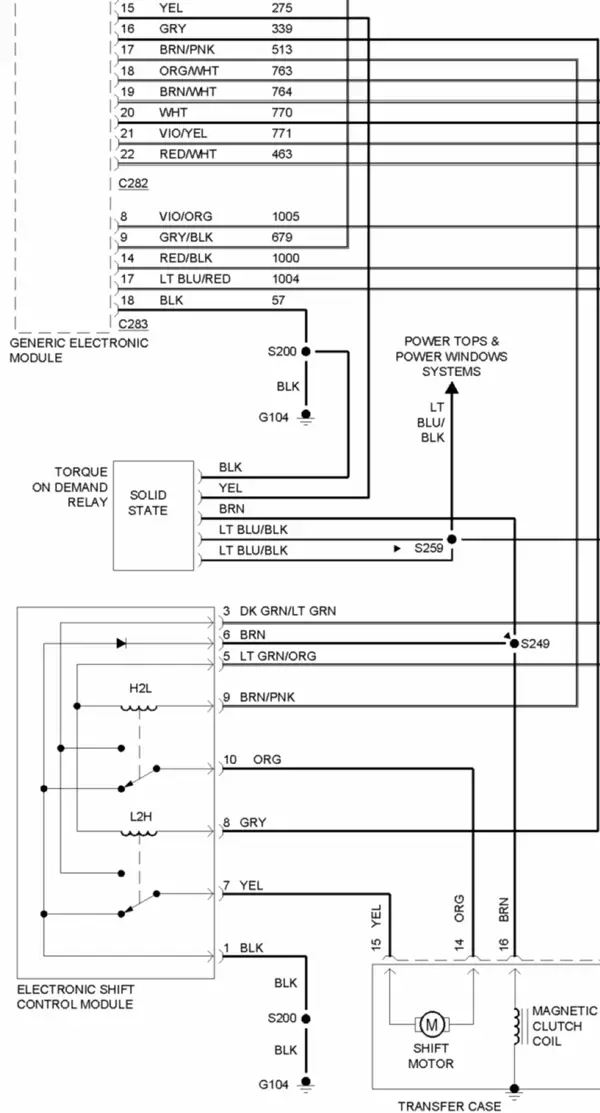

The TC shift motor is also a weak link, I'd verify that is good before being serious about a TC rebuild or swap. Those motors are rebuildable, used to be about $75 new, last time I looked ran $75 used. I'd rebuild one next time if I need it.

Is this also the same motor that shifts from normal to low range? If so, I can confirm that it works properly. I can hear it shift and then it drives fine in 4LO. Does it perform some other function besides shifting between HI and LO?
-Peter
That's it, just the one shifting device. It doesn't move much, just about three positions I think, one less in the auto 4WD versions. In the A4WD, there is not mechanical 4WD position used by the shift motor, just the normal and low range positions. As you already know, the 2WD is solely achieved by the brown wire, the one electrical trigger wire.
