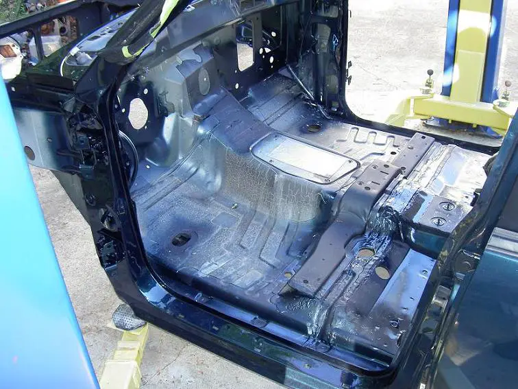

Driver's seat, here's a picture showing the two large holes that two wiring harnesses go through. It's under the back part of the seat. One harness goes to the frame, and the one you want is optional for 4WD trucks, it goes to the transfer case. This is my fuzzy memory, I swapped all this into my 99 back in 2006.
