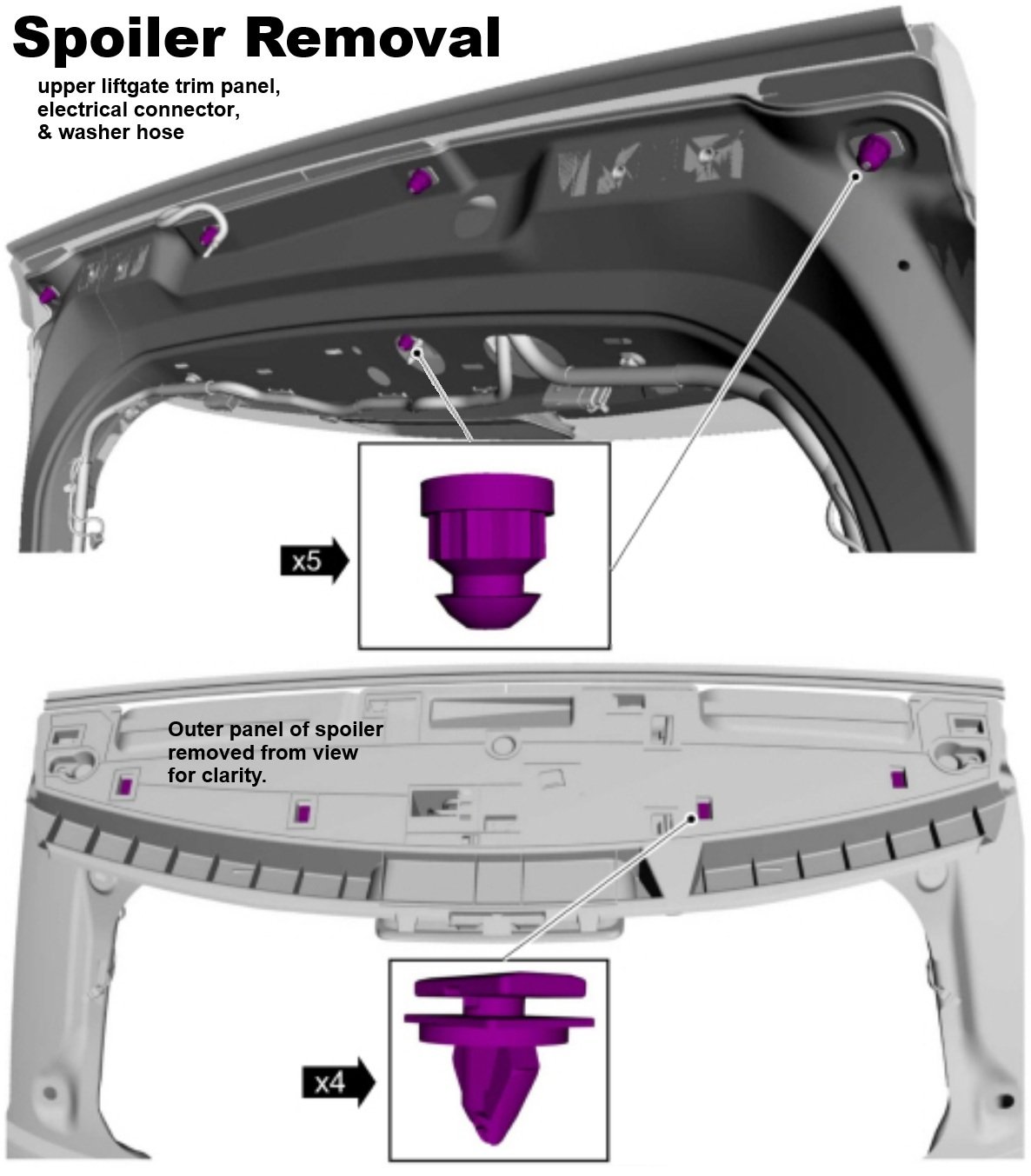

Rear Spoiler Removal
NOTE: If equipped with police package, on both sides: remove the retainers and the light covers.
Release the clips and remove the upper liftgate trim panel.
Disconnect the washer hose and electrical connector.
Remove the spoiler to liftgate fasteners. Torque: 55 lb.in (6.2 Nm)
Using a non-marring trim tool, disengage the retainer clips.
Remove the spoiler assembly.
