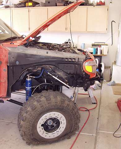

I was supposed to go to Truckhaven this weekend, but the weather forecast was for 50mph gusts along the freeway. Not what I want to encounter with my camper and trailer!
So... this became an opportunity to install some remanufactured cylinder heads in the Pumpkin.
I picked up a set of remanufactured heads for $270 from Bills Cylinder Head Exchange in Phoenix. I used the cores from my parts truck and they tested good so I didn't have to pay anything extra.
I also bought new rockershaft assemblies, pushrods, head bolts and gaskets from Ford Parts Network They had very good prices on these parts and they are brand new original equipment Ford parts.
I wish I had degreased my motor before I started paying special attention to the wire looms. My wires were caked with dust and grit which wants to drop into the motor when the valve covers are pulled.
I'm not going to go into detail about pulling the motor apart since there is a good tech article here: http://www.explorer4x4.com/lifters/lifters.htm
