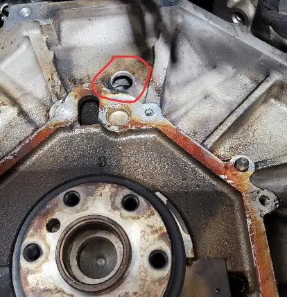

I have water coming out of my 2002 4.6 at a machine hole in the back of the engine
