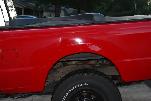

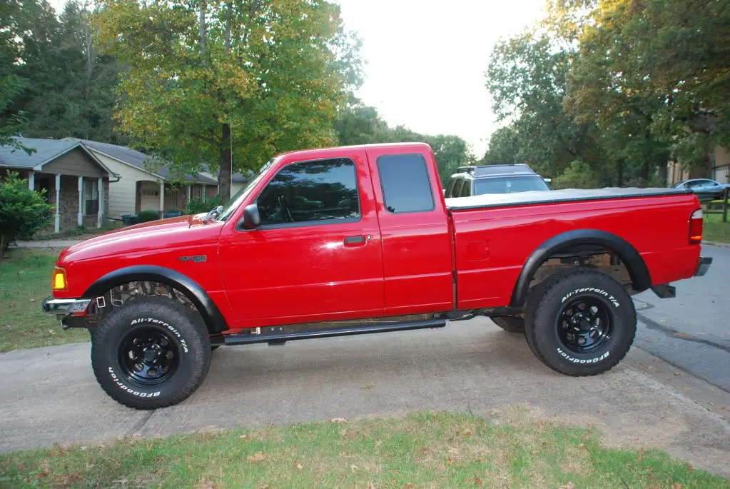

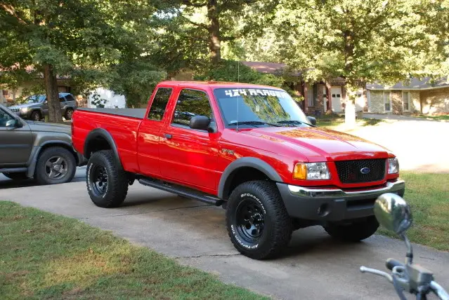

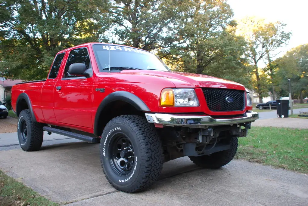

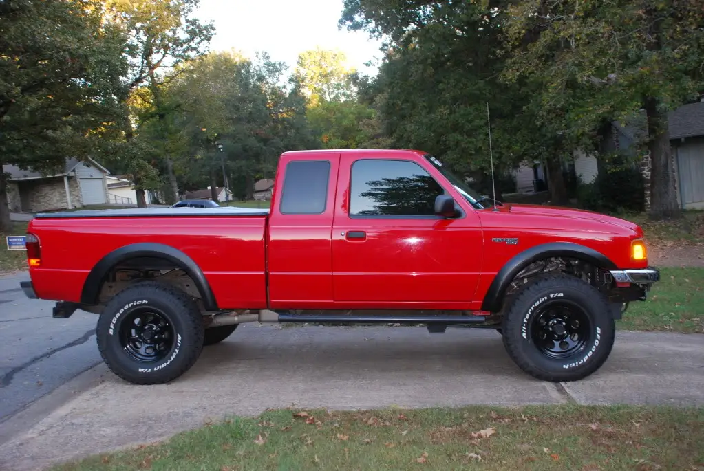

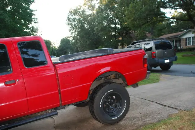

There were some request for pics of vehicles with the trim removed, so I felt obliged to post some up. IMHO, at least with this Ranger, as opposed to trying to fill the holes (impossible in my book) and moving forward without the trim, the best results will be either to paint and reinstall or go with an aftermarket fiberglass replacement fender. Some of you artistic types may even be able to cut the sheet metal and make it look great, but that option is WAY over my ability. Anyway, on to the pics.
Wide angle then a side shot of what the rear drivers side looks like with it removed:

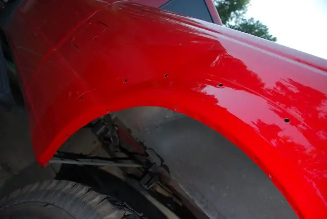

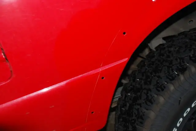

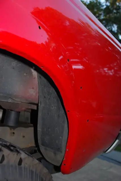

Closer inside the fender wells:
Apparently these things will scratch the paint. I may have to pick up some touch up paint and repair this, or not, it doesn't appear to be to the metal.

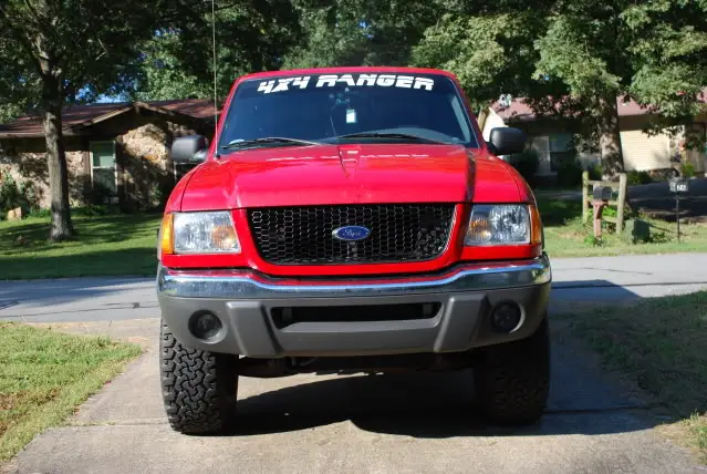

Ok, the grill is done. Here are some pics (I know it needs a wash LOL):
Before:
After:

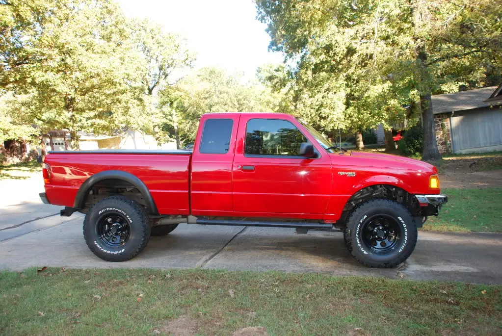

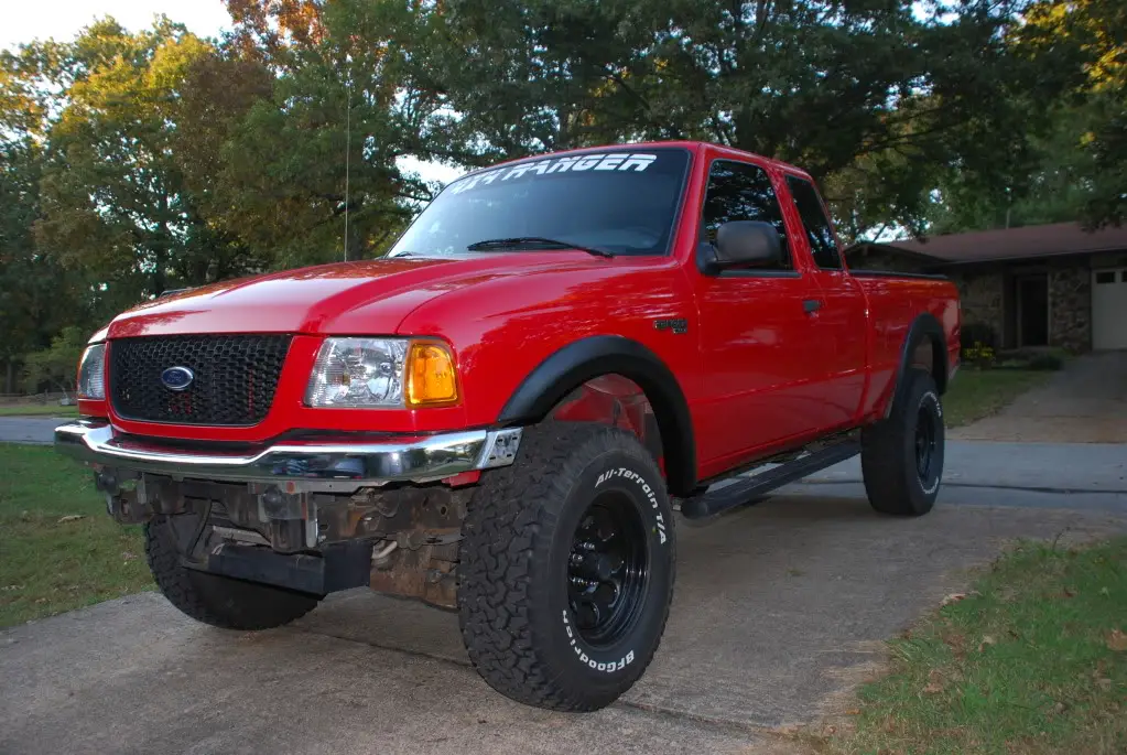

Here's an update:

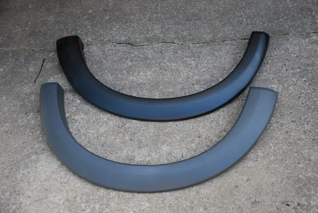

Got the rear trim done. I think it looks good, but I may take them to a pro and let them do them up smooth gloss black, or not. It *IS* a freakin truck after all ;-).
The Flares, one stock one painted:
With the back ones done:
Front:
Port:
Starboard:

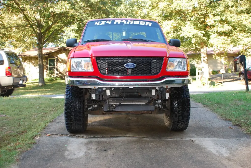

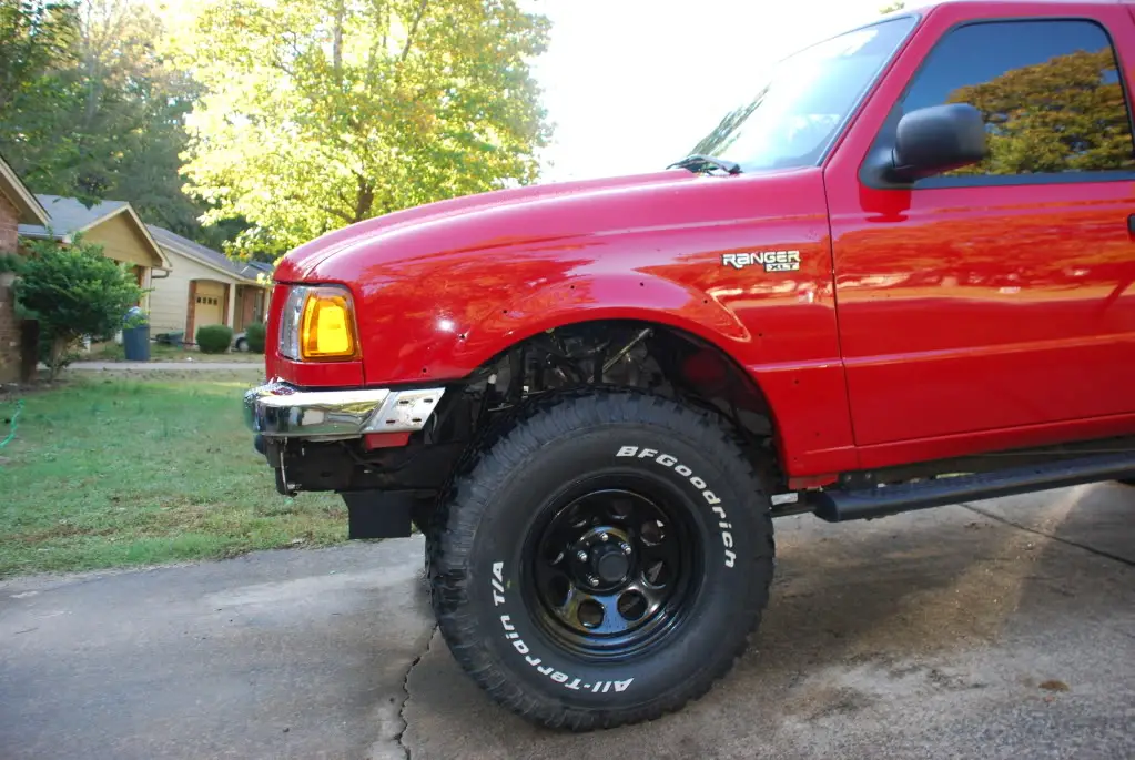

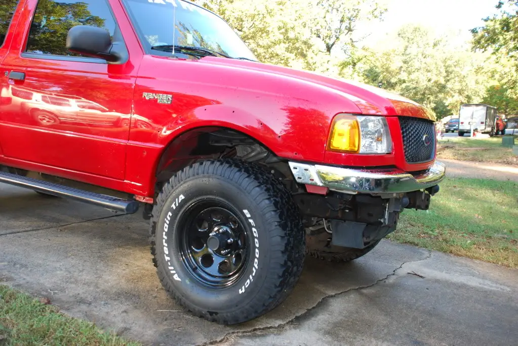

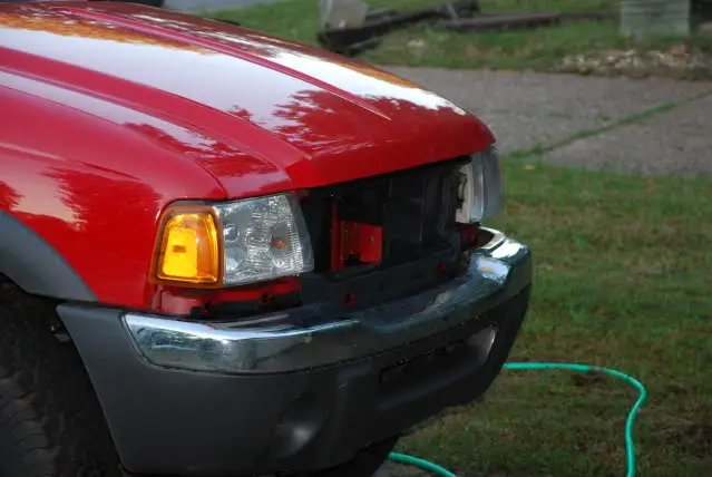

Pulled the front fender flares and front bumper trim, obligatory pics follow.
I'll paint the front fender flares the same as I did the rears.
Tomorrow I'll go by my bud's to discuss winch box and front light bar. The plan is to cut the sides off the bumper (the 4 slots tab on each side that holds the front trim on), have it stripped and powder coated black.
Though I'm going with a prerunner type build, it's also a 4x4 trail runner so a winch is a MUST in these parts.

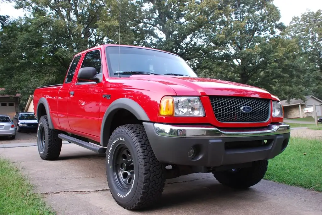

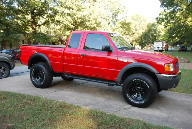

Well, the fender flares are done and I spoke with someone that's going to do the winch box, light rail and skid plate for me. Things are moving forward.
Pics of the flares done:
Obligatory family pic LOL:
