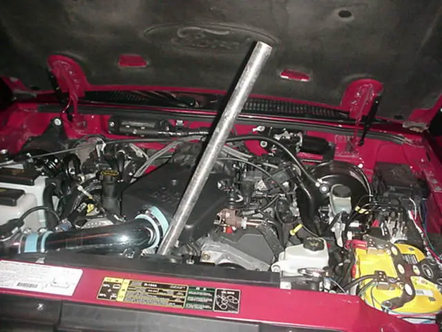

Makes all alot easier, I always use a cheater bar, pic is of my serp change awhile back.

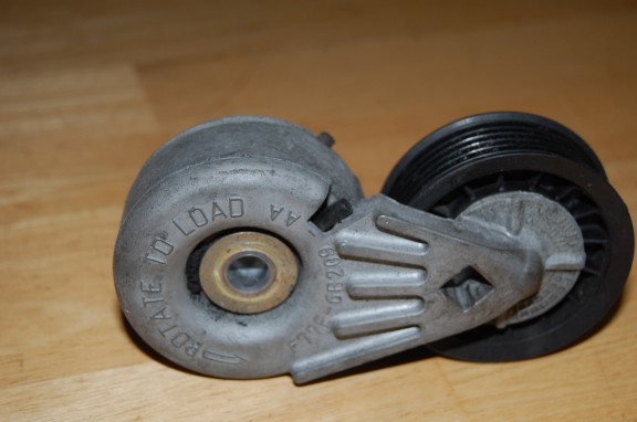

Anyone got any pictures of the belt tensioner hole? I'm just replacing the alt, I could just take the belt off the alt and tensioner right? So I don't have to re-do everything else?
Here is the belt tensioner off of my '99 SOHC.

It hard to get in there?
I was taking a quick look at it, I think the fan and there's this black tube (not the air tube) is in the way.. any tips?
I just changed my belt, I used my long ratchet/breaker bar, and went in from the passenger side, where the air box is. I had plenty of room with my mac intake, but I'm not sure how much room you will have with the stock air box. I'm pretty sure it's a 5/8 socket, use the shortest one you have, there isn't much room in there.

That's the upper radiator hose, it won't get in your way. I didn't have to take anything off when I changed my belt. You want to put your wrench down into the engine bay where the MAF meets the intake tube, then work it sideways and put it on the tensioner and pull up to loosen it. A 3/8" breaker bar is the perfect length to do it.
Another quick question.. (of course..) I've read on the forums to turn it counter-clockwise.. my sticker says turn clockwise?.. So uh... yeah.. which way? =\
When you put the breaker bar (or serpentine belt tool, or ratchet with a pipe... whatever works) one way will loosen it, one way will make it tighter. You've only got two choices, and the correct one will make itself self-evident in very short-order.
In my case (98 SOHC) CCW loosens it.
Why would it need to be tightened? I thought the tensioner for our applications was self adjusting?
