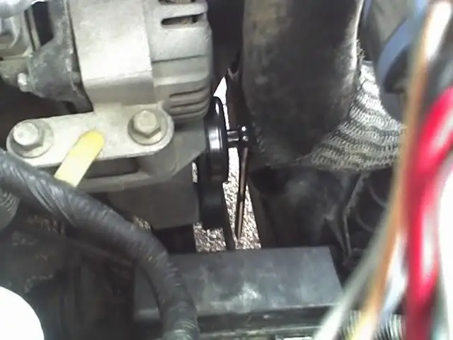

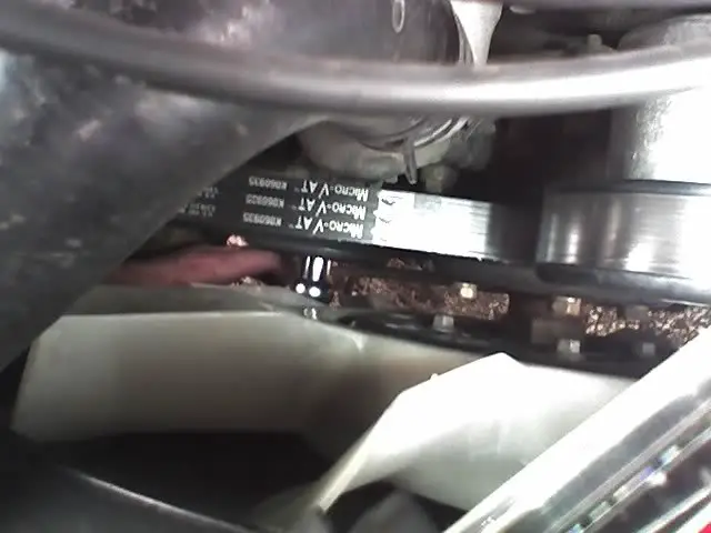

I got these pictures from WhiteLimited and Russ, but I'm still kinda lost.. could someone post maybe some different angles of where I'm supposed to put the ratchet?
I went outside a moment ago and took a look at it, but I can't seem to find the spot to crank? It's kind of dark out though, so I don't know.. might just not see it in this darkness.. but if someone could post some more information about the 5.0 Tensioner it would be helpful.

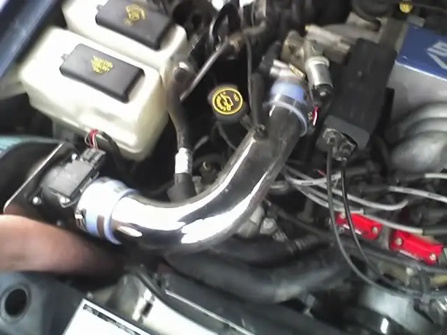

Remove the air cleaner outlet tube to gainbetter access from the top. Then, using the bolt in teh center with an apropriately sized socket, turn the tensioner bolt clockwise to release the tension from the belt.
This really should not be difficult... You only need to remove the intake tube from the air box and flex it out of the way.
