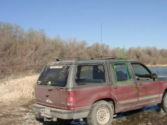

Does anyone know how much this usually costs to get replaced? Also, if anyone in or around Austin knows of a good place, let me know... it's the highlighted window, except on the driver side

Replace it your self!!! I bought a side window for $15. Take the panel off the inside, lower the window so you can see the rivits, nock out the center with an awl. drill out the rivits, replace the glass resecure with bolts or rivits, and put the panel back on.
