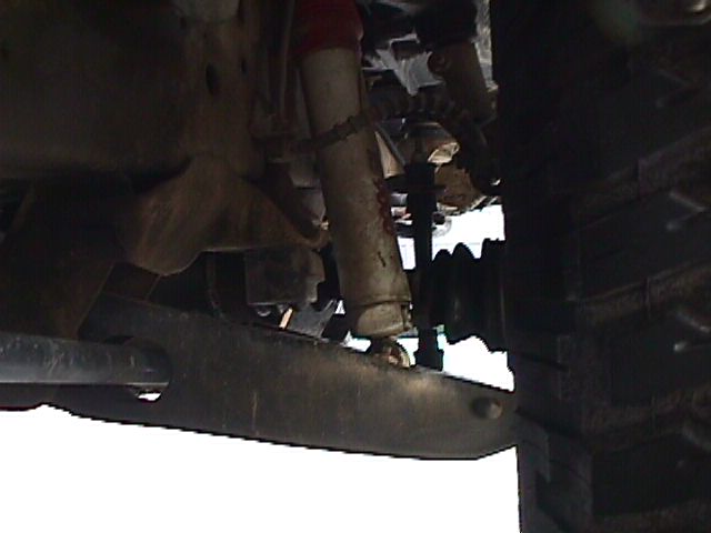

shock is dirty but you can see the mounts: (I will clean it up before shipping).

Did u get the right part shock for the front? I have ranchos in the front also but have my shock has an extension from the A-arm so that the shock won't hit anything.
That one works well if you move the CV boot a little, it is longer than stock. So it would work great on a 2wd.
