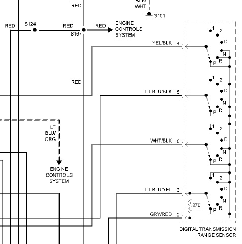

Below is a diagram of the digital transmission range selector (DTRS) for your vehicle.
If you have no jumper to the GRY/RED connector pin then Drive should be indicated. Did you think it was necessary to jumper one of the pins (YEL/BLK or WHT/BLK) to GRY/RED in order to get the starter to engage? If so, I don't think that's necessary.
Wow 2000StreetRod that's perfect. We did jump two cables but I honestly forgot which ones. The wires we connected did allow the starter to crank, but unfortunately the rpm will only go up to 4700 (that's all that the sct programmer allows in neutral for whatever reason).

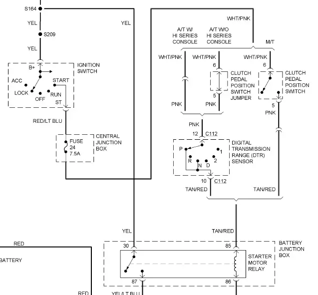

If you perform the above then the PCM should ignore the DTRS position but you still need the jumper from PNK to TAN/RD to enable the starter. Be advised that unless you have wired in a clutch pedal position switch your starter can be engaged when the clutch is engaged.

So I just checked, we did connect pin 12 (pink) to pin 10 (tan/red stripe) because it wouldn't start before that...
I'll give that a shot, thank you :thumbsup:
