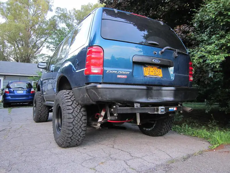

Metal part of rear bumper is Eastwood rubberized undercoating, after a thorough cleaning and treatment with rust converter.

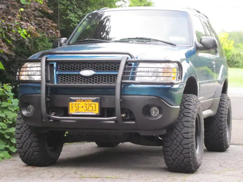

Plastic on the top of the bumper, and all the body plastic trim around to the nose is Krylon Fusion, which is made for painting plastic. Again, make sure everything is completely clean. Bed liner can peel off that plastic in sheets.
Good luck with the paint work. They look 100 percent better when turned to black.
