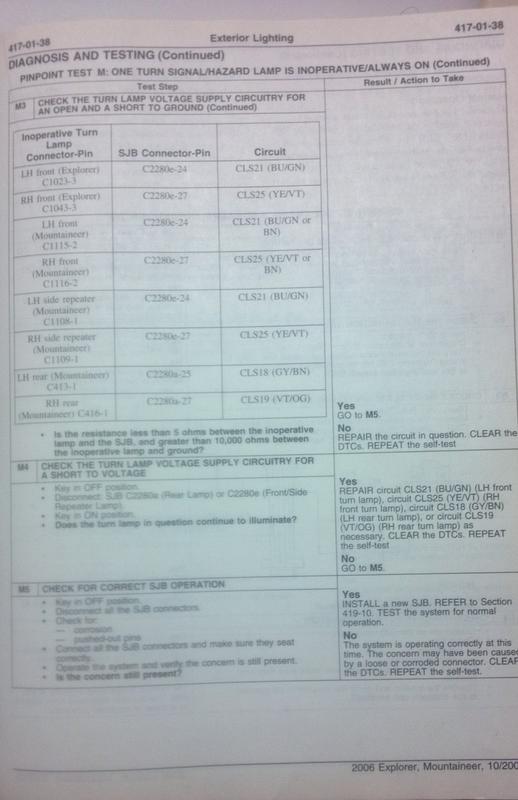

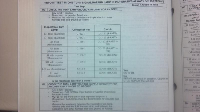

Here's some troubleshooting from the factory manuals.
