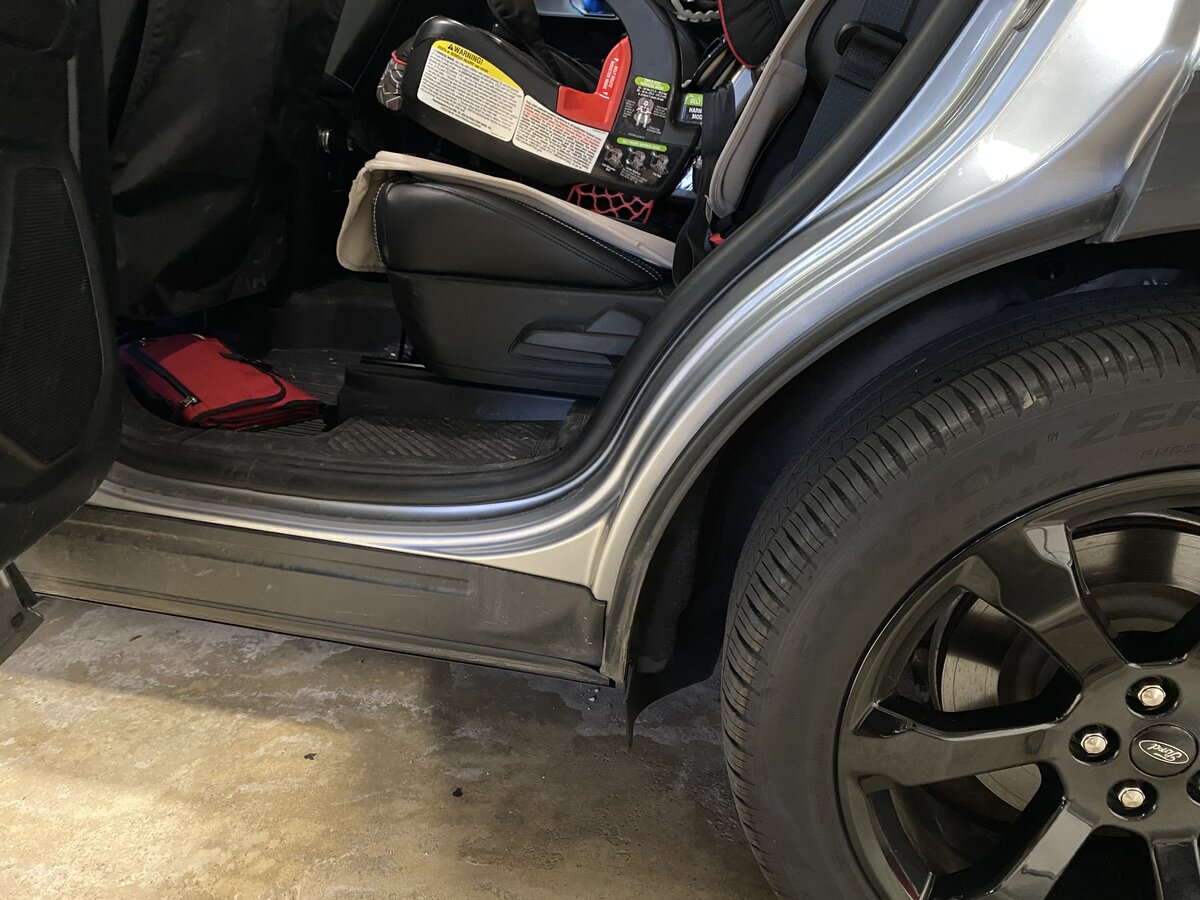

My bubbling is on the door itself, in the area of the seam where the outside skin wraps around and ends, over top of the inner door panel, all painted body color. No seam sealer evident, just a sharp edge that has begun to bubble on all 4 doors.

I assume my 17 issue is a combination of the weather seal design that covers the door jambs/inner doors with salt/abrasive grit and sand, plus no seam sealer.
I am going to have it taken to metal and repaired. Just unfortunate for a nice vehicle that's 3.5 years old. I may just RTV the 21 upon delivery, but I imagine that if it has the updated seals, that would be a huge improvement.

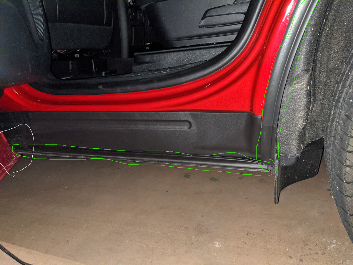

From looking at your photos, I think you are missing some seals around the wheel well and lower body. unless this is new to the 2021 models. I just checked on mine and there is a seal around the wheel well and along the bottom of the rocker panel.
You can see that there is just a small amount of splash toward the front of the door from the gap between the doors, but the rest of the area is clean and protected by the seals I circled.
Finally heading to the dealer next week so they can document what is missing on my explorer. Can someone verify if there is supposed to be seals in this same place but on the front doors too. I assume there is supposed to be.

The lower seal is one piece that runs from the front doors to the back

this is my 2020 ST with 6/19 build. Looks identical to the 2021. Unfortunately, missing parts are commonplace with our cars and Ford is taking the position of dealing with it after the sale--if you even notice that it's missing. I'd be surprised if both sides were missing the trim pieces though.
Update...so that c pillar trim is actually a seal that I was missing on the side with the salt issue. That seal at the bottom running the full length of both doors like in post 6a is missing also. There is a very thin seal in a groove at the very bottom of the plastic trim piece where you step. My local dealer was being difficult because he didn't think all that stuff should be missing and possibly fell off... along with my air deflector and tow hook. Good grief. At least my customer service gal from ford was more than willing to help and called my local dealer to get me in and get it taken care of.
