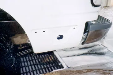

while i agree, a steel pan would be nice, i dont think you guys understand how much extra work is involved in welding in a pan on the explorer. you are correct, you cant mold in a 'glass pan without fear of it eventually cracking around the corners. as far as wanting a steel one for seriously lowered X's, a steel pan is very, very thin guage. if it ever hits something, its screwed just like a glass pan. also, a glass pan can be repaired much easier than trying to straighten a thin steel one. also, to weld in a pan, you will have to get rid of the splashguards. the lower rear quarter's (whats under the guards) are a bit higher up than the guard itself, and will look alittle funny. you will also have to have this area of the truck painted, and blended in with stock paint. a "bolt on" glass pan can be painted seperate. also, you will have to weld in all the junk underneath the guards, as they are anything but smooth...

not trying to discourage you from welded in steel, as i think this is by far the best look. however, am i going to spend about 100 hrs. on the rear of a truck worth $6k, to make it look 100% cool? or am i going to spend 20hrs. to make it look 90% cool? ill take 10% less coolness for 80 hrs. less work anyday.:confused:
