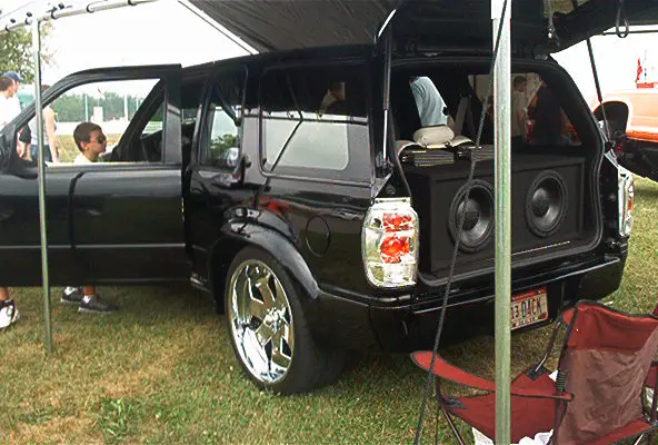

Does anybody know what size rims the guy in the black X has??????
the one wiht suicide doors and a roll pan? 22"s
nnnick
Sweat!!! I am getting 22" and was wondering what they would look like. Also is that yours and if not do ya know what route he went on lowering it??? Thanks
