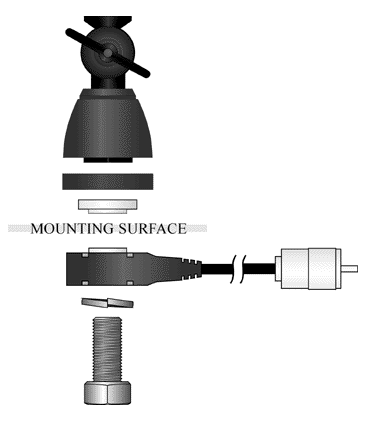

I'm wanting to install a permanently mounted cb antenna and figured I would mount it above the dome light, so I wouldnt have to pull the headliner down to do it.
I unscrewed the dome light and found, not the roof but another peice of metal somehow suspended below the roof. I've felt around the metal for screws, but havent been able to find them. Is there any way to access the roof this way without taking down the headliner?
also can the roof in that area support a cb antenna?

but I want to put a permanently mounted antenna center of the vehicle, approximately above the dome light... the cable would attach below the roof...
heres a diagram
having the cable go out the hatch wouldnt be much help...

how did you get thru the metal plate thats below the roof that the dome light connects to?
and how did you route the wire? I was thinking I could prolly partially pull down one of the A pillars and use a wire snake to pull the coax thru.

here is a little breakdown of the antenna. Also, I was wrong I think. The antenna did not break per say. The hollow tube is plastic and given the right amount of force, it will separate from the ends. The only thing that may be wrong is at the top. I don't know if the long wire at the top of the coil was soldered in or just inserts. This piece is between the whip and the joint.
hmmmm I thought that was a spring, not a plastic piece...
