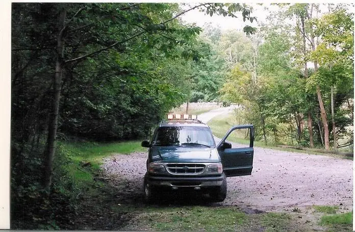

I saw another thread of a guy ho posted a picture of lights on his roof and then I saw a picture of SkanlaxJMO’s X a while ago along with one other whom I can’t remember. Here is a more recent picture his (got it from recent thread talking about roof rack lights). Those two were the main reason I did it. I liked the tougher/different look and saw it as a project I could tackle by myself. (http://www.explorerforum.com/forums/showthread.php?t=165525)
He had the square Baja lights on his roof which I got but for my brush guard. So my figuring is that I can’t have a box like look so I went to Wal-Mart and bought a pair of circle ones for $20 bucks combined. I also bought a nicer switch to match the other one I had to go with my brush guard lights. That cost me $3. I also bought extra wire for around $5 because coming from the roof will take up some wire. Then I grabbed a fuse (came in a pack of like 8) for $3. I also bought wire loom to protect the wires from the rain and New England snow. It cost me $4. It was a good buy because I didn’t know any better with my brush guard lights, but I quickly learned when I had to do some rewiring because snow and rain got to them. Anyway the total cost of this project was $35 for me. Of course you can put a lot nicer lights and better wire for a cost of course. You are also going to want to have some wire tape for the loom and wire connections but that’s a supply you find in the garage usually.

So here is the finished product
I am at college now and for the first couple months I will not have the X with me. YES they do work although I don’t have any pictures with them on and I unhooked the wire from the battery before I left because the X is sitting in my garage until I come home.
