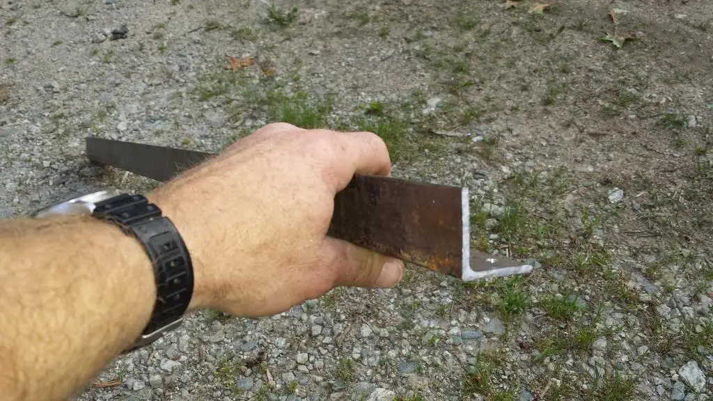

I started with a 10 foot piece of 1 1/2 inch angle iron:
Then I cut 2 pieces about an inch or so wide off the end:

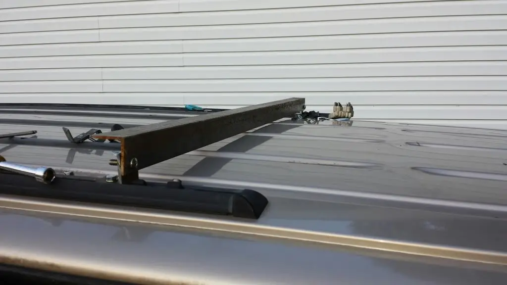

Next, I cut a piece of the angle iron the same width as the factory roof rack.

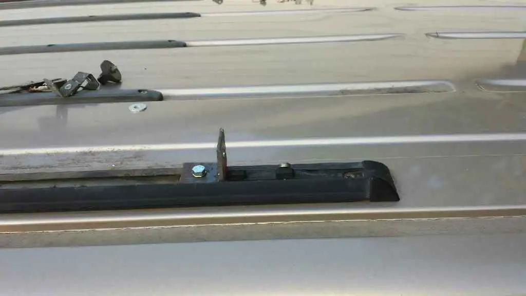

I then mounted the two 1 inch pieces to the front of the factory rails using M6-1.0 X 12 mm screws:
Next, I mounted the 4 foot or so piece to the short ones using 1/4 X 20 screws and lock nuts:

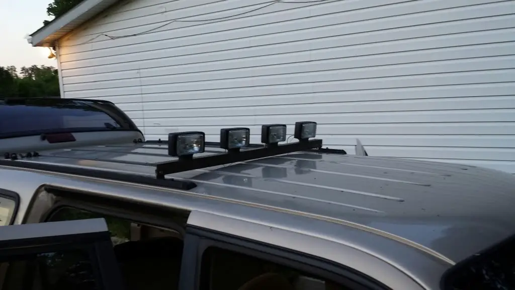

Next, I mounted 2 pairs of auto part store special driving lights to the "cross bar":

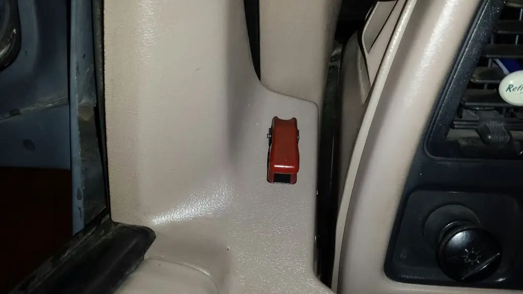

After that, it was just a matter of running the wires to a relay, heat shrink tubing them, and putting in the switch! Also found a place for the switch just above the side mirror controls on the door!

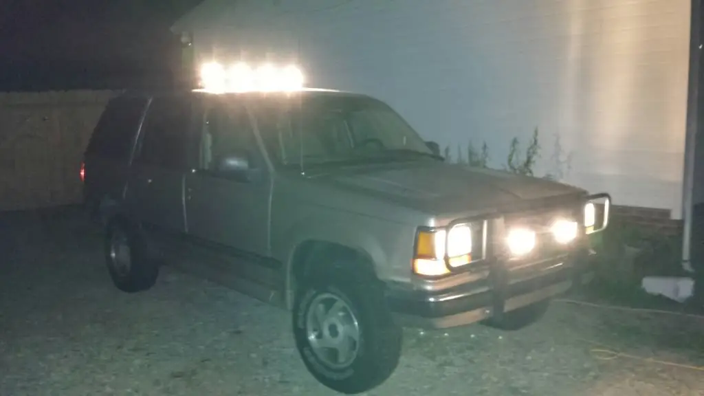

Here's what the final product looks like, even though I just ran the wiring in the door, because this is just temporary until I build the safari rack!
What do you think?
nice! looks like a cool and simple idea, do they sit too low so the roof line cuts off the beams? i have heard some people having issues with this, my roof basket sits pretty high so i dont have any issues (same lights as yours) but they are aimed just shy of low beam distance. also that is a great spot for the switch, wouldnt have thought of that, mine are all on the plastic panel under the steering column, very easy to route wires and out of the way.
truck looks great btw, did you build teh brush guard yourself?
Do you notice a shadowy effect from the roof lights? I've heard upper lights should be mounted as close to the windshield/driver as possible. Extend your roof rails by cutting a j/y rail in half and add to the existing rail.
Blue91ex, no the roof doesn't seem to cut the beams off any, and no, I didn't build the brush guard, I actually found it at the pull apart for 10 bucks! It was on a b-II! I am planning to build a new front bumper with a brush guard on it and a rear bumper with a swing out on it when I make the safari basket.
Produceman, no I haven't noticed a shadow effect, but when I build the safari rack, they will be mounted farther forward. This was just a quick "temporary" fix!
