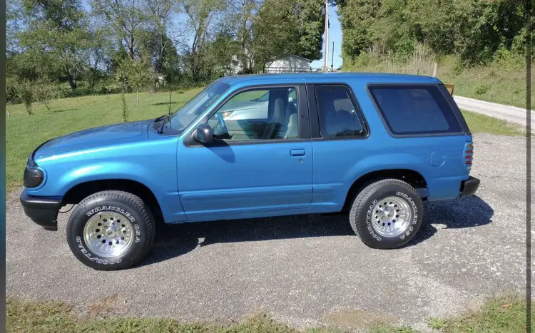

I've got 95 sport explorer. And I have no roof rack on it. I went to the local salvage yard, pulled one and noticed the top has the bolt holes in the top.
Mine has no bolt hole or any mounting holes for one.
Where or how do I mount a roof rack on it. It looks naked.

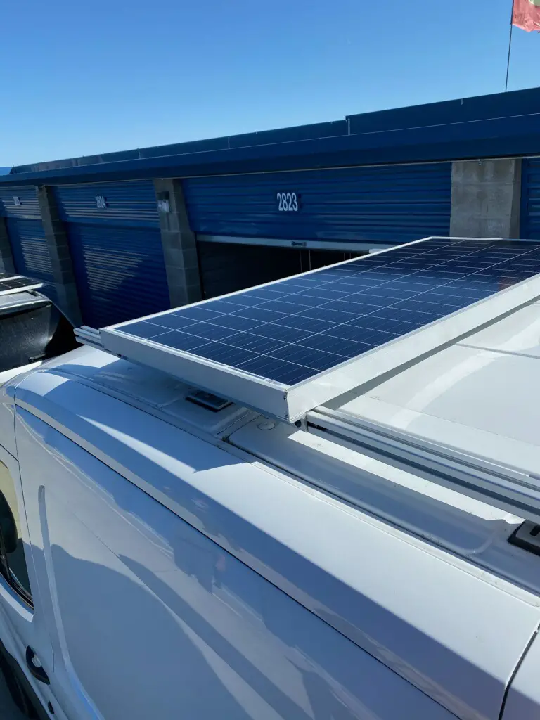

I put solar panels on Ford Transit vans for conversion van / recreational use, and was going to attempt to replicate this on my 95 explorer.
Nothing too complex - just some brackets and 1515 rail to raise the panels high enough to clear the center of the roof. My measurements look like it can work - if I remove the factory rails first.
The Ford Transits also have a welded in nut at I think 8 positions on the roof for mounting stuff. Same concept, just a stronger rating.
In theory, I can get 2 panels up there if I use the 1515 rails approach, so ~300 watts.

I have some extra panels at home and at the shop that I plugged into the van (now planned for the explorer) to generate extra power when needed.
When I am doing yard work out front, it is actually easier to just plug into the vehicle than to run a cord to the garage, so that happens as well.
Once you have a normal 120 vac outlet in your vehicle, it becomes difficult to imagine not having it.
