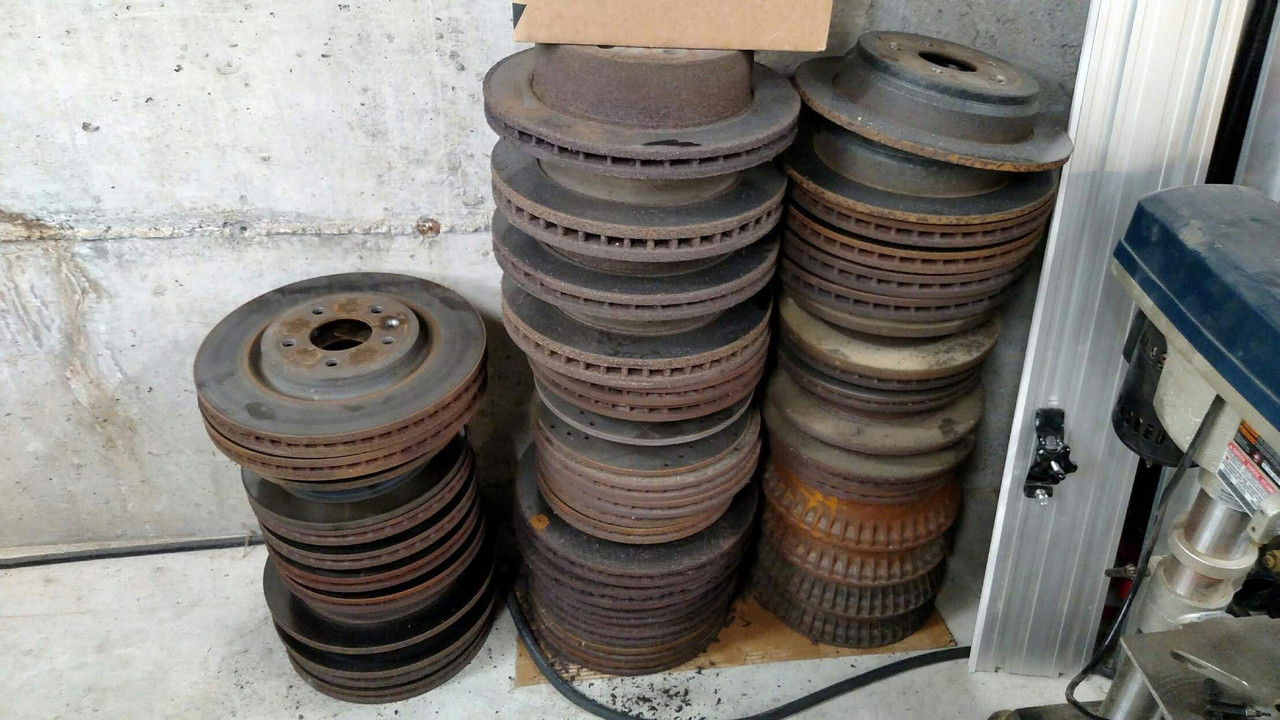

Hey there, I have done my share of brake jobs. My brother and I have been doing our families' cars for years, plus friends who need help. Here is a batch of rotors that need to be dropped off at the recycler:
My recommendation is to get the Power Stop coated rotors ("Geomet") from Rock Auto. I am so done with rusty rotors. I have done Stop Tech as well with the painted hubs, but IMO the Power Stop hold up better. I put them on my wife's Odyssey, and they look as shiny as they day I put them on, so I just put them on my Explorer. Preventing rust also protects against other side effects of the rotors deteriorating due to rust, like brake noise and vibration, IMO.
