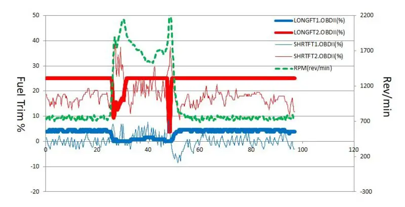

4th thing: bought a Bluetooth OBDII scanner (amazon, BAFX scanner) and loaded FORScan on a laptop – maybe it doesn’t take much, but I’m really impressed with what one can do with $23 and free software!
-scans show long term and short term fuel trim on Bank 1 to be +/- 5% - and stay that way as a crank RPMs up
-scans show long term and short term fuel trim on Bank 2 to be very high, LTFT2 pegged at 25%, STFT2 near 20%, and increases with higher RPMs
-data looks something like this (importing data into excel and plotting) (attached the jpeg if the insert doesn't work...):
5th thing: with the STFT2 and LTFT2 staying high as a increased RPMs, I concluded that this didn’t look like a vacuum leak, or at least if it was it was a really really bad one, which my smoke test didn’t show. So I thought maybe we’re looking at clogged or dead injectors. Put a mechanic’s stethoscope on the injectors I could get to (easy on bank 1, bank 2 harder) and all seemed to be clicking away. So I cleaned them and swapped them
