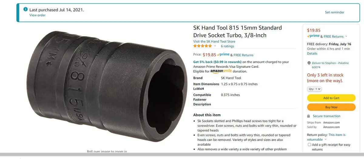

Both bolts broke loose in under 10 min. using the turbo socket. I had to use a 1/2" to 3/8" adapter to use my longer 1/2" drive longer breaker bar on the first bolt. Once you have one nut out you can tap on the caliper bracket in the opposite direction to help loosen the second bolt. I only needed my 3/8" breaker bar on that one.
Instead of using a hand sledge I used a big brass hammer that I have to drive the socket on. Less chance of damaging the socket.
This socket was worth it's weight in gold, it made this job that easy and should work for anyone else who gets stuck like I did.

I was expecting something much thicker and heavier so I had my doubts, but it went on pretty easy with the hammer and never slipped at all. From what I experienced I think that you would snap your cheater or the bolt before the socket slipped.

Got the driver's side brakes done with no issue. When I went to do the passenger side brakes the caliper bracket bolts were pretty rusted up. So I wire brushed them by hand and soaked everything in Kroil for a day. Finally went at it tonight and they both rounded off. I've ordered this from amazon and it will be here in two days.
Amazon product ASIN B002Z32PGM
If that doesn't work I'm about to clean up the pads and rotor, reinstall and button it all back up and drive it 4 blocks to a local shop. I'm really beginning to hate rust.
I don't have a torch, has anyone resorted to grinding the bolt heads off and sliding the bracket and rotor off together. I can get a new bracket pretty easy.
