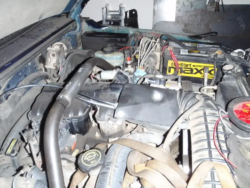

hey just a thought but you may want to disconect the battery before you weld anymore! welding with the battery hooked up has been known to cause computer or elec. probs.... just a thought...

Yah I've read that before but I've always just gone ahead and welded and never had problems so its all good.

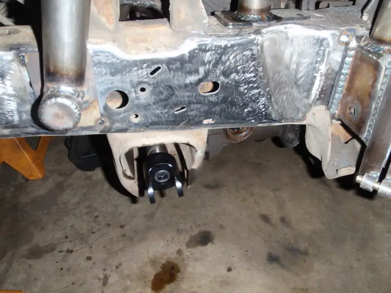

Got the steering clevis on today, shackle flip is done and Deavers are on for the hell of it. Pretty much sitting around waiting for parts.

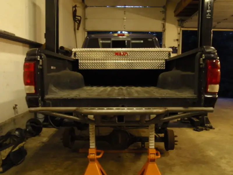

Maybe I'll start cutting holes in the bed to kill some time?

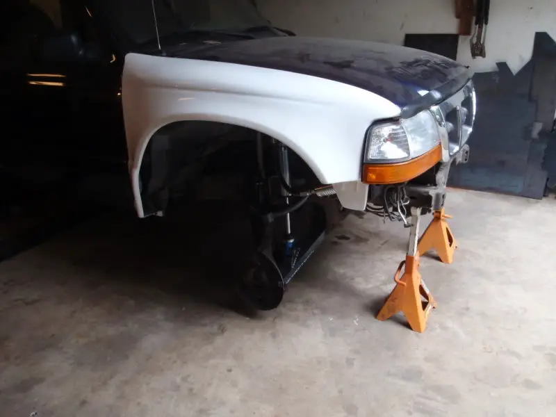

Well I guess the third time is a charm, got me some ranger fenders today:thumbsup:
Fixin' to start on the front bumper now:D There is a 25# mystery package coming on Thursday with some FOX goodies in it. Sure hope it has everything:rolleyes:

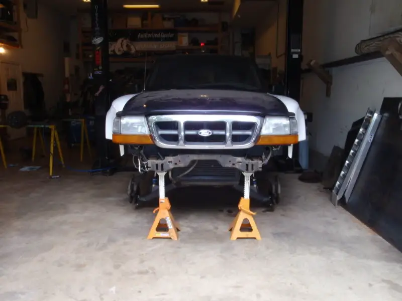

Chopped this sucker off...
Ready for tube. Gotta run to Kanadia real quick tomorrow to pick up a new shipment of Ketchup chips but I'll be back in time for Thursday night BBQ'n and a nice full day of fabbing on Friday:D
