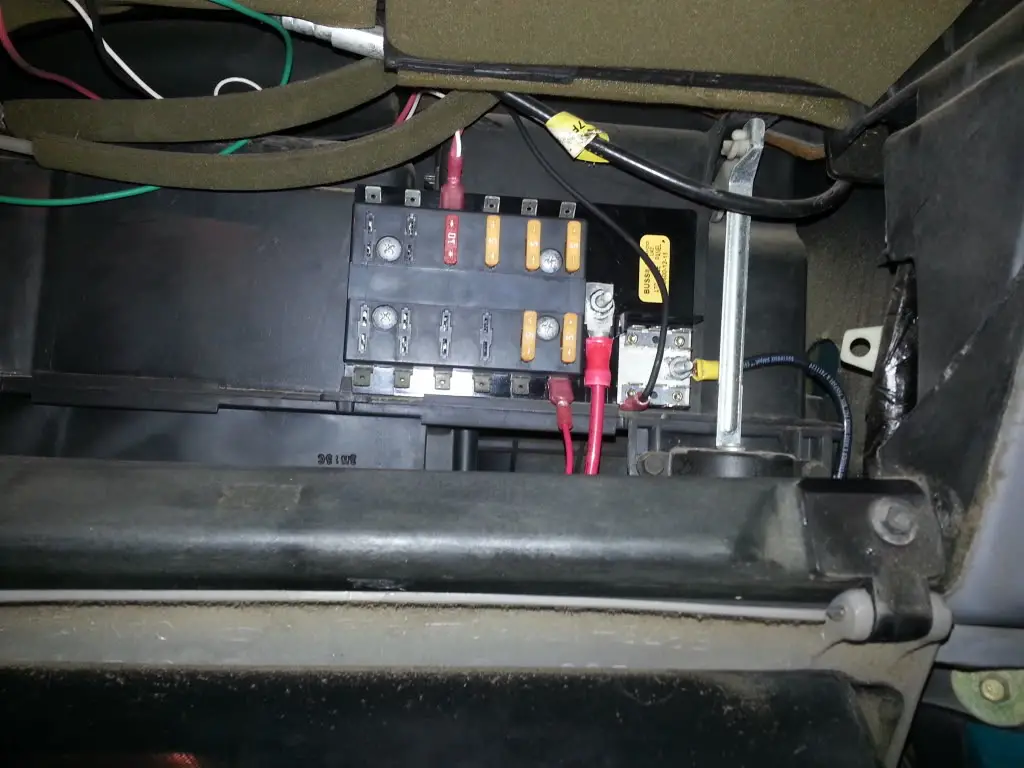

I took and ran a 8g wire off the starter relay to self resetting 50amp circuit breaker,then to a bosch 75 amp relay,then to a 50amp sub fuse panel behind my glove box..the bosch relay is turned on by a "key on" lead so the new fuse box is only hot with key on..the 50amp fuse box does require to be grounded to frame.
The 2nd bosch relay runs my fan
