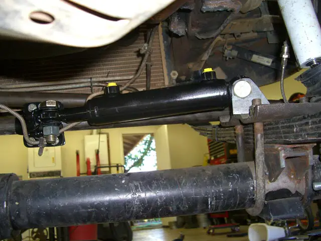

I ask again, is it wise to mount the ram on the u-bolt plate? Dosent seem like a good idea to me.
We can find out together.

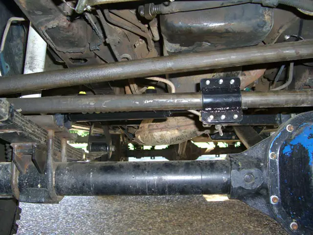

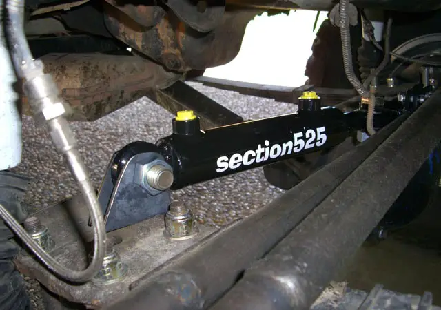

Okay IZ.. how crazy am I going to have to get on this other side mount? :)
If I just welded the tabs on much like the tie-rod side, would it be good for at least a while? It's going to eventually be changed anyways once I go back to torsion bars.

I think you're good to go with that mount baby -- just tack weld the mount to the plate that bolts to the leaf pack (blind tack it, no room for a helmet under there, just close them eyes or turn away), unbolt the plate and finish the welds .. dont forget to put enough washers to prevent the tabs from squeezing together during final welding ;).
It will be fine. I have had mine mounted that way for 2 years now with no issues pushing 38s. Just check the u-bolt torque before every or every other trip out with it.
