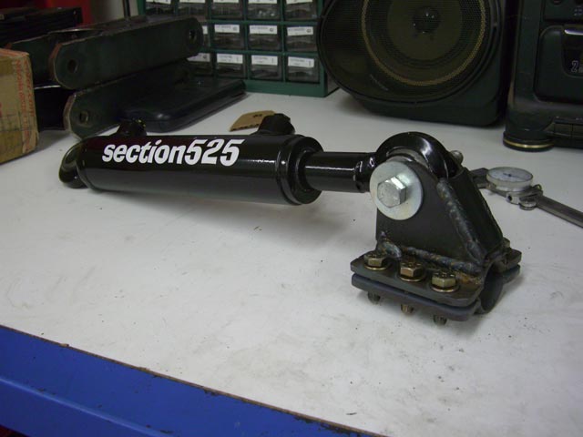

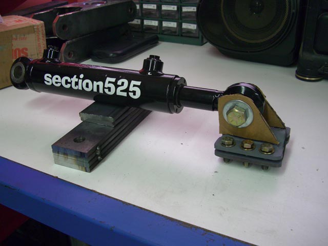

So tomorrow I'll plasma out the tabs and weld them onto the tie-rod clamp I made about.. what.. three years ago? :(
I'm probably going to just make some hokiebert u-bolt plate tab for right now. I don't plan on keeping the leaf spring setup for long so I don't want to waste time with too much bling.

those cardboard tabs are pretty bling. what are you cutting out metal ones for? just paint them metalic silver.
I would. But I am all out of JB Weld and Gorilla Glue. :(

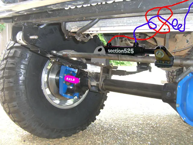

I'm curious to see how are you going to attach the other end of the cylinder to the axle...

Ghey tabs off the u-bolt plates. Gawd. Like this:
****... I need to add my axles.\

EDIT: i think you might have hydraulic hose issues - they're all over the place :p:
Those are straws. I was filling it up with hydraulic fluid.

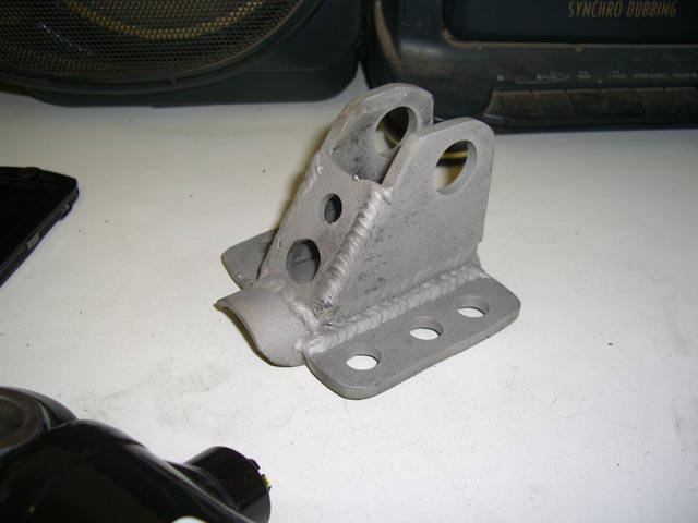

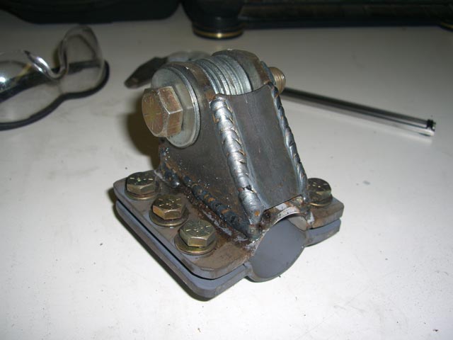

Apparently I didn't have enough washers between the tabs because after all the welding was done the heim would not go in. :mad: Even after a lot of coaxing with the 7" flap wheel. :thumbdwn:
So tomorrow will be clamp #2.
Remember: Measure twice, weld once.
What do you mean the heim would not go in? Isnt the heim in the clamp in the second pic?
Since I was only able to flap so far into the tabs.. this is as far as it would go. I don't want to beat on it either.
Oh ok -- well at least you're getting welding practice out of it :D

is it wise/acceptable to mount the ram on the spring plate and at such an angle?
I would think that will put stresses on your leaf and u-bolts that you dont want.
Section's just being lazy :p: -- the cylinder will probably mount behind or on top of the steering link.
It's a photoshop. There's only so much I could do! :p:
Let me make a diagram... :)
Okay.. here is a top view. The ram is going to be level with the tie-rod and directly behind it if you were looking from the front.
