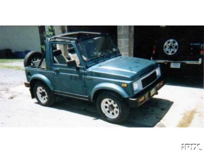

Other option get a trail rig and keep the X. I know alot of people running trail rigs with less than 2k in them. One guy with only $600 in his sami. Granted they look like hell, but hey its a purpose built vehicle.
If you decide to put the IFS parts under there (why?) look for people around here that are doing an SAS on theirs and get their parts used for cheap. If you wait several months mine will be availible too. But really, if you do it do it right the first time. don't mess with the IFS.
Buy a trail rig cheap :D and keep the X. I got this one for $800. Lift and lockers coming :)
