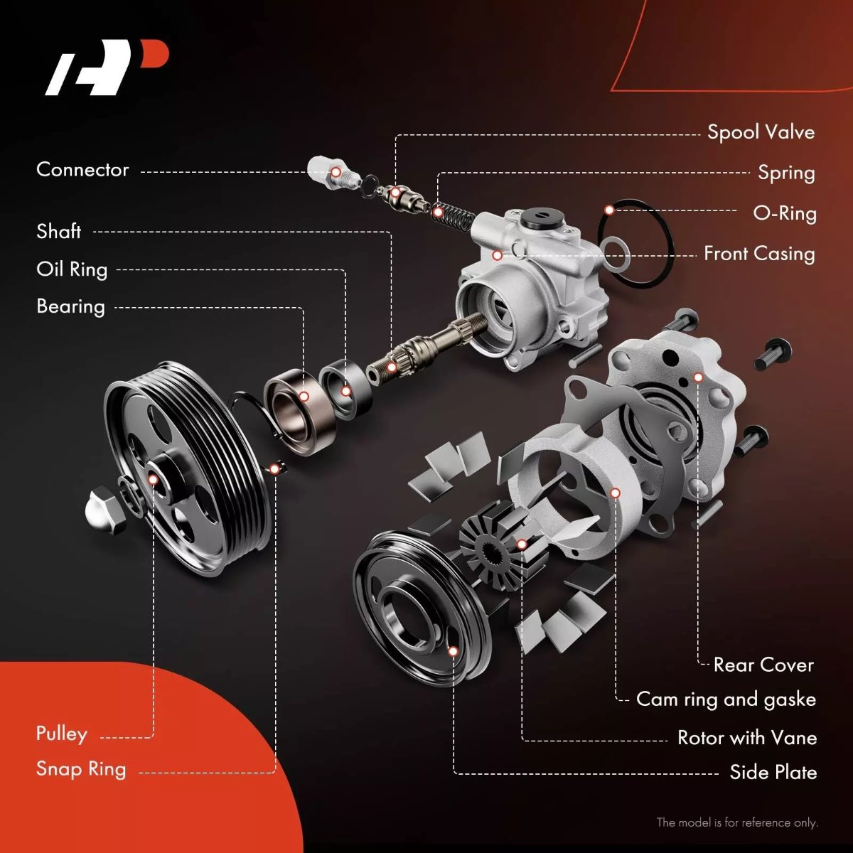

PS pump is junk. Has anyone had good luck with aftermarket or remans? I'd imagine a "used" or junk yard special will have the dame issue as mine at some point soon as mine is low mileage. Checked around online and dealerships can't get a new one. Limited options out there
As everything that is remanufactured, you don't know nothing about quality and how it is reman.
I would prefer a new power steering pump.
I don't have any issues with my 97 sohc PS pump, but i recognized that the pulley has some in/out play too
to compensate a little belt unalignment. Never had a hopping squealing belt, but bad alternator beerings
make similar noises.
