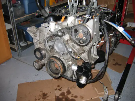

Do you have a picture of it or know where I can find one?
You mean like this?
tensioner is uin bottom left corner, you can see the idler has been removed from this 5.0L for now
Here's another pic of a 5.0L with the full dress still on it:
You can see the idler pulley is between the alternator and power steering pump
the tensioner pulley is below the alternator and above a much smaller idler pulley.
The bottom pulley is the crankshaft, the one above it is the waterpump and on the right hadn side is the AC compressor.
Pictured is a 96 Explorer 5.0L all 96-01 Explorer 5.0L V8 will be the SAME
Idler and tensioner are FLAT surface
Small idler is ribbed surface.

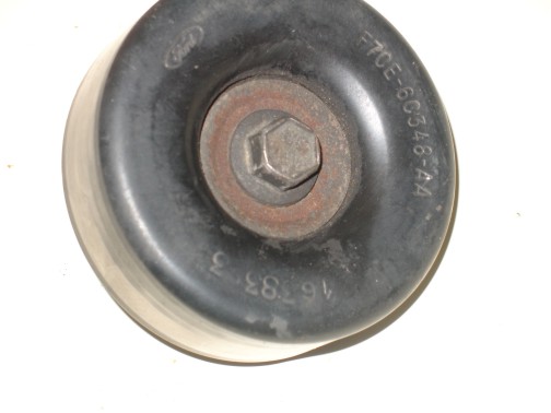

This is an idler pulley off my '99 SOHC.
It is Ford part number F7CZ-60348-AA
