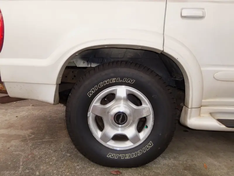

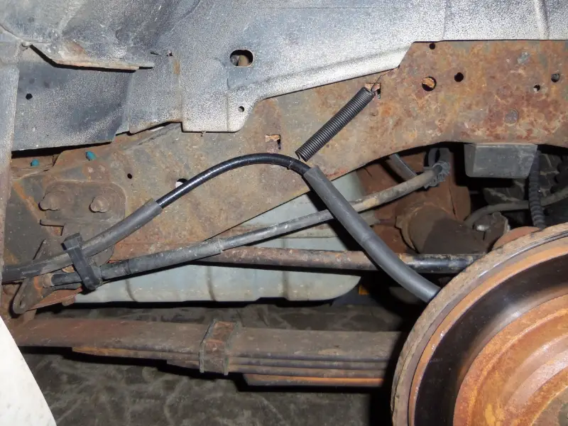

The ground straps are universal ones from NAPA. The driver's side ground strap literally crumbled in my fingers. Passenger's side wasn't much better.
I wire wheeled the rust away at the mounting points, then installed the new straps with new hardware and new star lockwashers. May not be much of an improvement, but it can't be worse!

Jesus, and I thought I was OCD about maintaining the vehicles I own, haha.
If you want to fully fix the rust, you're pretty much looking at cutting and replacing. There are ways to seal it and prevent it from getting worse though. POR15 paint is the most effective, but also is very time consuming with the preprep and paint process needing to be pretty much perfect. Or you can get something like a black undercoating oil or wax from Eastwood or Amsoil to keep it from getting worse until you're ready to do some actual paint and body repairs. I've used both, and they're both awesome. The Eastwood is actually black though, whereas the Amsoil is more amberish. The Amsoil will make things darker, almost to the point of being black. If you look at my Sport Trac registry, you'll see the difference with the Amsoil, especially on the rear frame and axle.

Yeah...I have no illusions about the rust. There will be cutting discs and MIG welding in my Explorer's future.

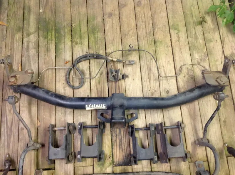

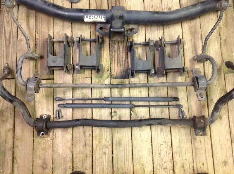

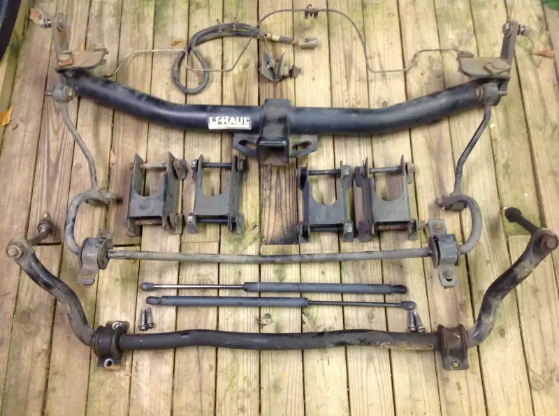

Good haul at the junkyard today!
For $60, I got:
-tubular, bolt-in hitch receiver, labeled 'U-Haul #78129'
-factory 4-pin trailer plug-in adapter harness
-rear anti-sway bar and links
-front 34mm anti-sway bar
-two sets of rear spring shackles, one set from a 1996, the other from a 1999
-rear axle metal brake line
-good set of rear lift gate struts
-all the mounting hardware, brackets, etc... required to install the above items
All of these parts are MUCH less rusty than what is on my Explorer.
Now, I just have to get time to start installin these and all the other parts I have amassed.

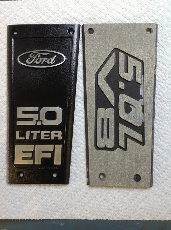

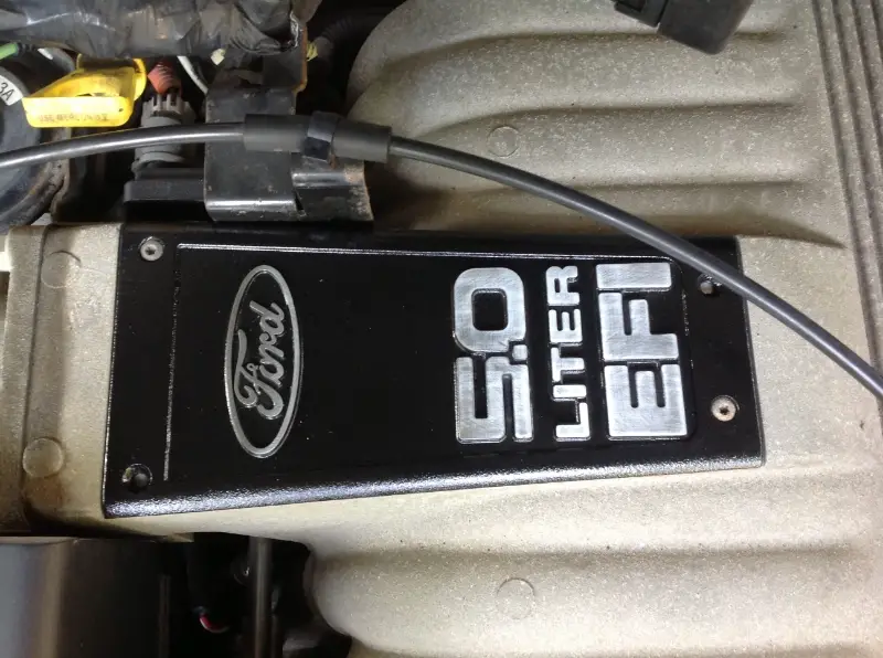

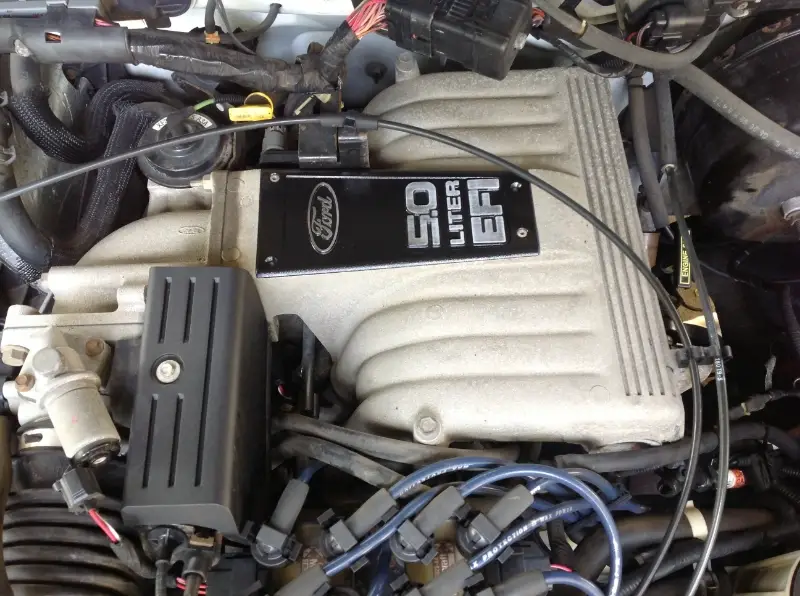

New bling time!

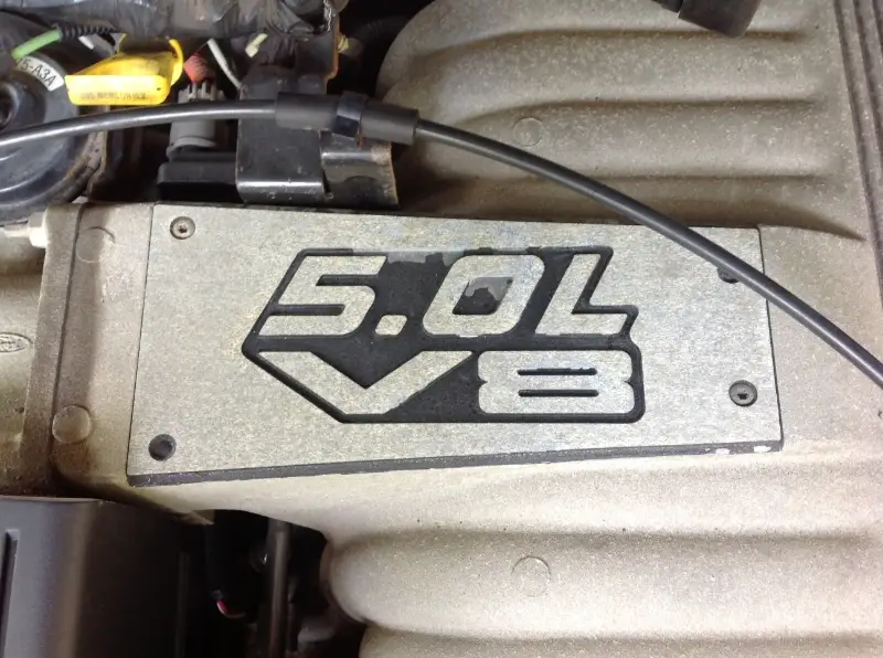

I have been OK, but not overly excited by the stock '5.0L V8' trim plate on the intake manifold of the 5.0 in my Explorer. Well, I tripped over this trim plate and like it much better! Probably from a 90's Mustang or such.
Seth K. Pyle

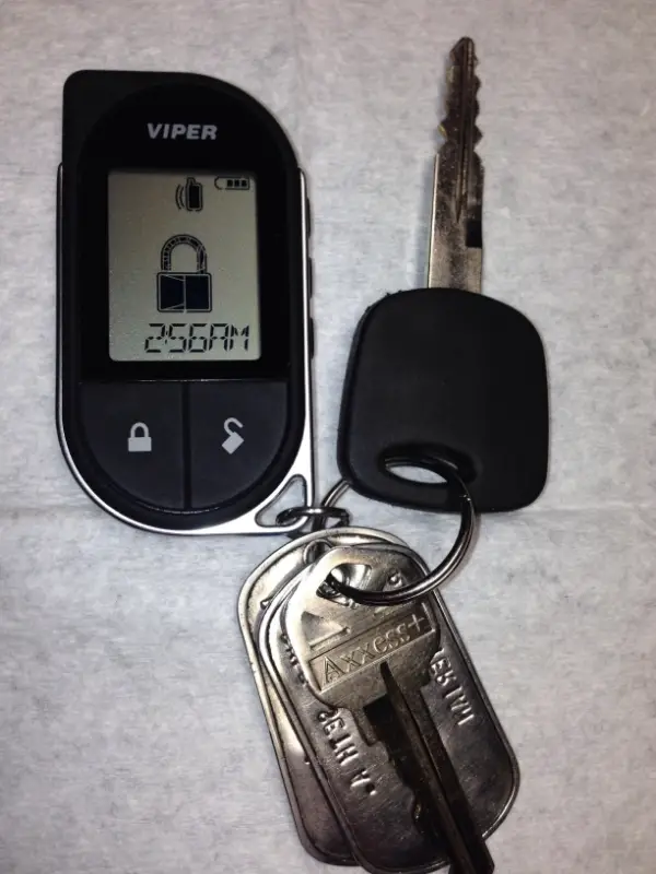

Spent some money on my Explorer...:D
My wife has been razzing me about how her 2008 Chevrolet Equinox has factory remote start on it. To add insult to injury, I had to show her how to use it.
Well, I had a Viper 5706V LC3 2-Way LCD Security and Remote Start System installed in my Explorer. I am having all kinds of fun with it. Damn good transmitting power. I can be sitting in the middle of the plant and am able to start my Explorer before I get off work. Nice.

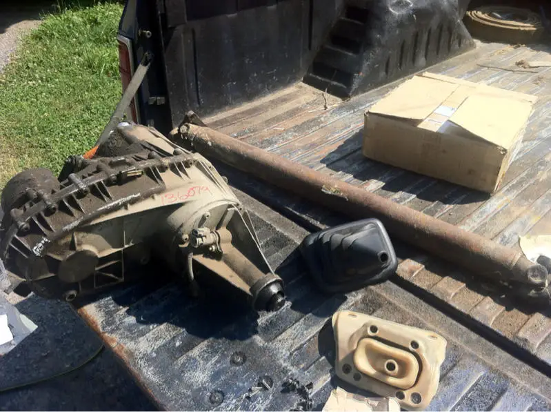

Nice...

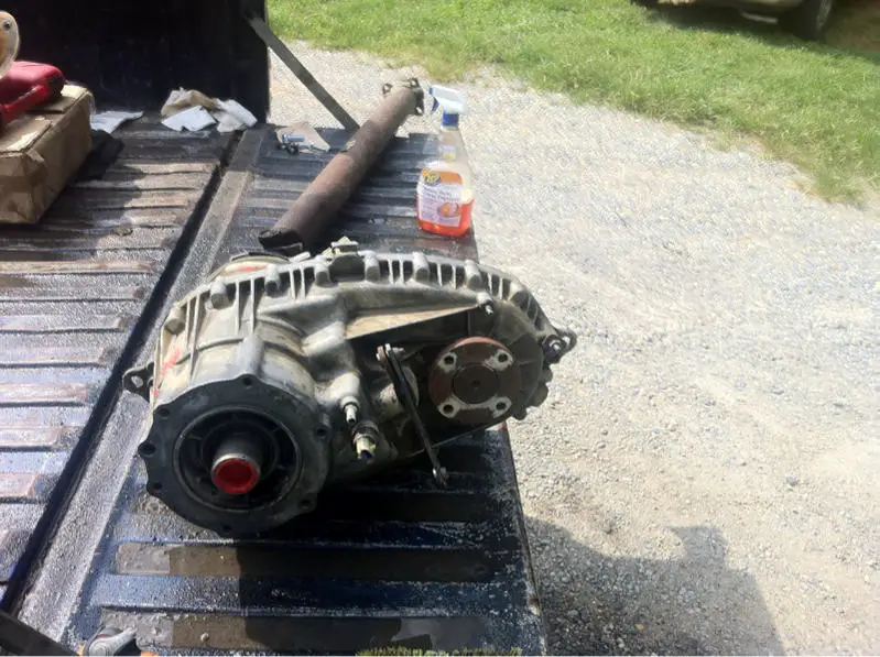

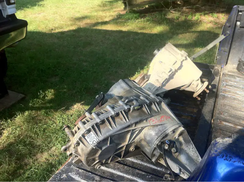

Are you still running the BW4404 AWD transfer case?
Seth K. Pyle
Ihve4x4
March 15, 2011
114
7
Silver Spring MD
1998 Limited
4406 is a must
4404 on top 4406 on bottom.

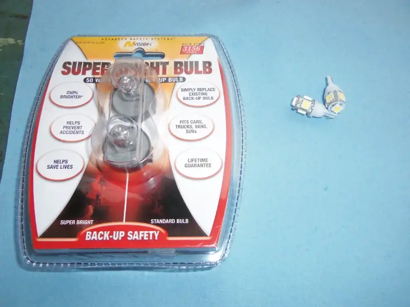

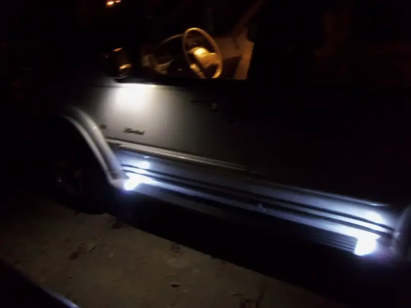

Had a helluva weekend working on my Explorer! Finally got several things done that I have wanted for awhile.

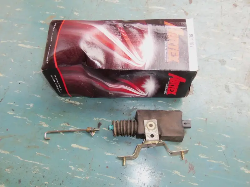

Started off small. Replaced the failing power lock actuator in the liftgate.
Note the rod I pried off the actuator. This was an attempt to remove the actuator. It failed. The manual is correct. The only way to unhook the actuator linkage rod is to unbolt the carrier plate for all the rod linkages for the latches, locks, window, etc...:eek:

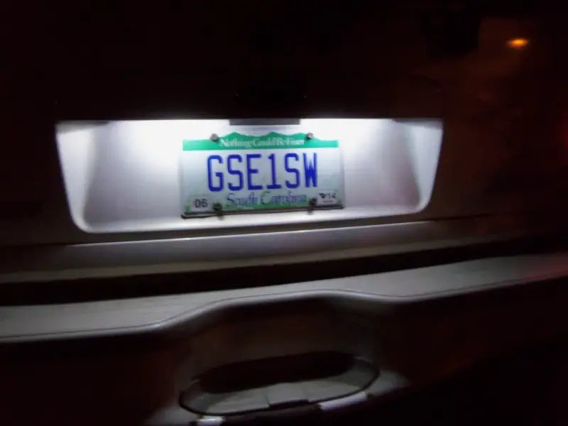

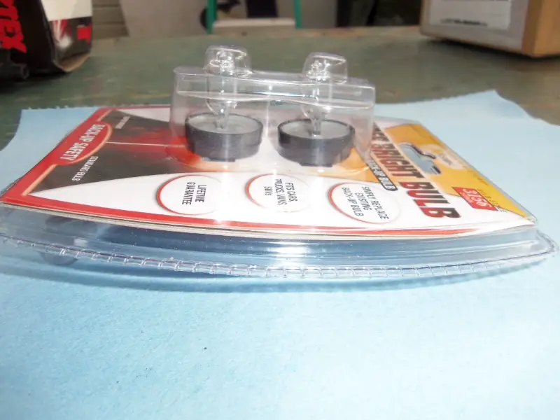

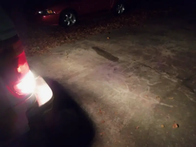

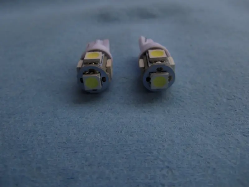

I installed 50W halogen bulbs in the reverse lights, and better LED bulbs in the puddle lamps, running boards, and license plate lights.
I got the halogen bulbs from Amazon.com, and the 5 SMD LED bulbs from ebay. These LED bulbs are now in the running board and license plate lamps. I don't have a photo of the 42 SMD LED bulbs I put in the puddle lamps.
Sorry about the fuzzy photo. I was trying to shoot it in the dark before the motion lights came on under the carport.
I understand halogen bulbs produce a considerable amount of heat, which is bad in a plastic housing. However, I have been running halogen reverse lights in my vehicles for years. The trick is to not leave them on for too long.

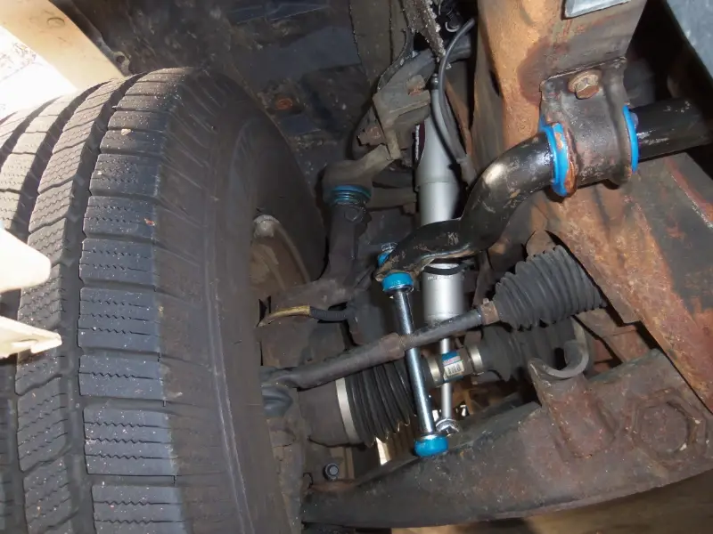

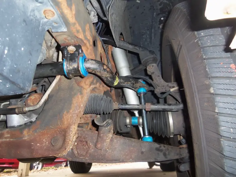

Took care of some front suspension issues this weekend.
Replaced the rusty original Motorcraft front shocks with Monroe Reflex shocks. I won't say they were rusty, but I had to break one of the upper studs.
Replaced everything associated with the front anti-sway bar. I got a 34mm bar with mounting brackets and hardware from a 1999 Explorer in a junkyard. They are less rusty than the ones on my Explorer. I installed the bar with Raybestos polyurethane end link kits and NAPA Chassis polyurethane mounting bushings. I cheated and lubricated ALL bushings with Energy Suspension synthetic bushing grease.
Junkyard bar and endlinks, before cleaning.
End links didn't want to come off. I won.
Loose endlinks, installed approximately 5 years and 46,000 miles ago.
Cleaned junkyard bar and bar from my Explorer.
Now, the front of my Explorer feels a little more stable, and doesn't rattle over bumps. The only thing left is to replace the inner and outer tie rods. I have new Moog pieces waiting in my shop.
More to come on the rear suspension.

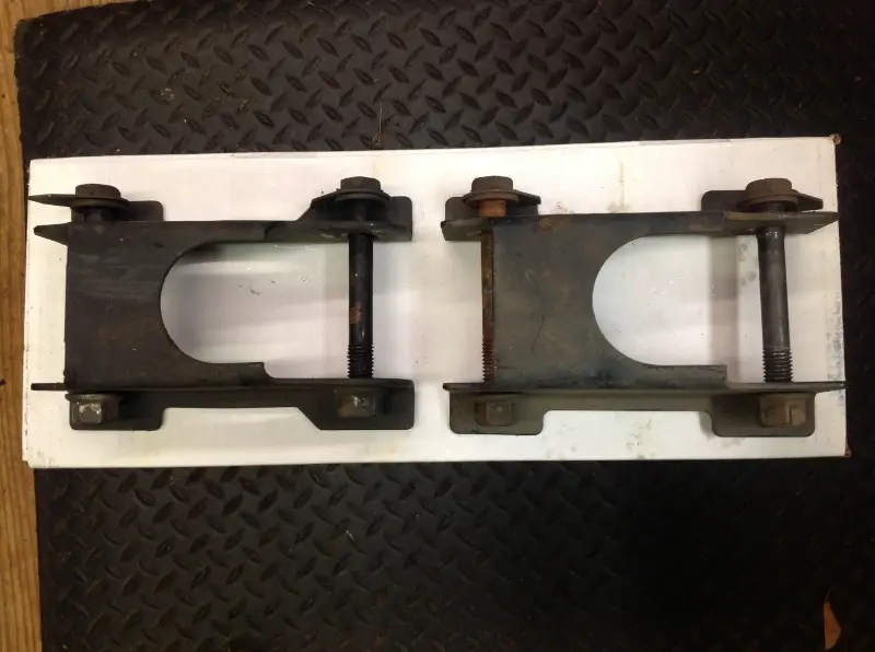

Biggest problem was the rear spring shackles. They were rusty tissue paper. Mom never met a snowstorm she didn't like. Snow in Ohio means salted roads. I am hassling her now to keep her 2008 Eddie Bauer Explorer clean this winter.
Anyway, I am lucky that junkyards in my area have plenty of Explorers with far less rust than mine.
I was able to bend the left shackle by hand with no problem. The lower bolt for the passenger's side shackle had to be removed with a combination of vise grips, 2 lb hammer, big drift, violence, and many inappropriate words.
No rust, much better. Donor shackles went on with anti-sieze on the bolts.

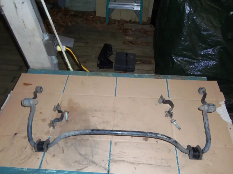

Replaced everything associated with the rear anti-sway bar. I got a rear bar, endlinks, mounting brackets, and hardware from a 1999 Explorer in a junkyard. These parts were less rusty than the ones I had. I installed the bar and endlinks with Ford sway bar insulator mounting bushings and Raybestos polyurethane end link bushing kits. I cheated and lubricated ALL the bushings with Energy Suspension synthetic bushing grease.
Junkyard bar, links, and mounting hardware before cleaning.
Only replacement bushings I found were from the dealer. Nothing aftermarket.
Cleaned endlinks and bushing kits.
Completed endlinks ready to go on.
Finally got to install my junkyard U-Haul 'hidden hitch' style receiver. It took more work than I expected. Initially, there were clearance issues, and not just with the 16" spare.
I didn't pay close enough attention to the Explorer I removed the hitch from to see if it had the same vertical ribs under the bumper as mine did. There were thick metal ribs that hung down, and merged into safety chain holes under the bumper on my Explorer. The hitch hit those. Also, where Mom kissed that light pole years ago, the bumper isn't right. The frame doesn't look bent, the bumper doesn't look bent, the brackets don't look bent, but it is pushed closer to the body on the driver's side.
After forcing the hitch in place and cramming the hardware into the bolt holes, I was not surprised to find the 16" spare didn't fit. I slept on the problem. The next morning, I cut the ribs off the bottom of the bumper, and trimmed the back side of the hitch. I had already cut off the spare tire protector from the rear cross member that carries the evap vapor canister assembly. The hitch fit much better. And, with the right amount of finagling and holding my mouth just right, the 16" spare fit and just cleared the coil over springs. :D
Junkyard hitch in all its glory. I removed the U-Haul sticker.
Ribs trimmed from under the bumper.
Trimmed back side of the hitch.
Trimmed the ends of the hitch for clearance for the shackles to flex if necessary.
Hitch nicely tucked up under the bumper. Yes, I am looking for another bumper. This one is not really savable due to the dent.
Spare tire against the back of the hitch.
Spare tire clearance to the passenger's side coil over spring.
Spare tire clearance to the driver's side coil over spring. It doesn't look like it, but there is just enough clearance.
Found a factory trailer harness in the junkyard. Just had to clean it up and install it to the factory trailer harness connector in the back corner of the body. I packed both ends with dielectric grease.
While I was at it, I installed a much less rusty spare tire winch.

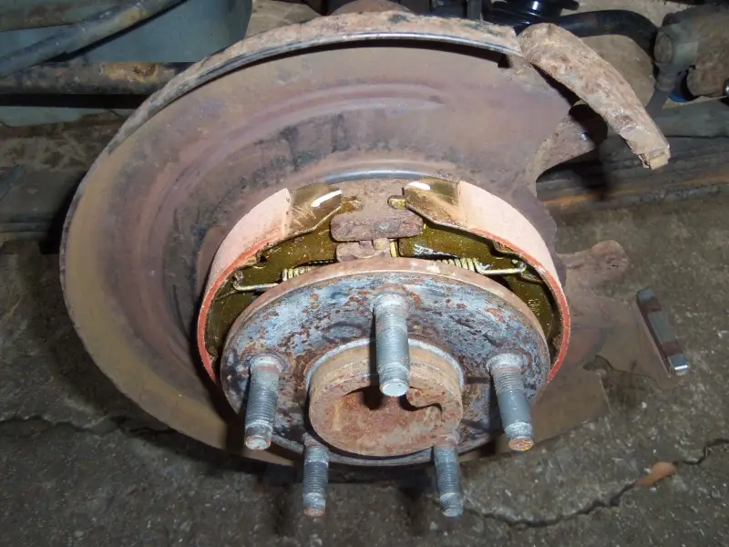

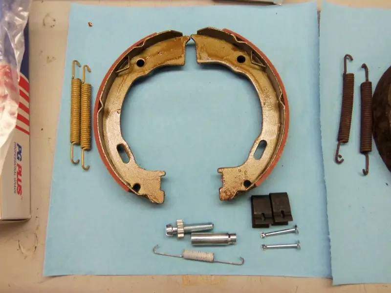

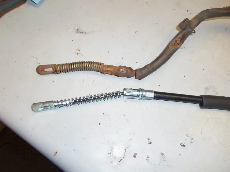

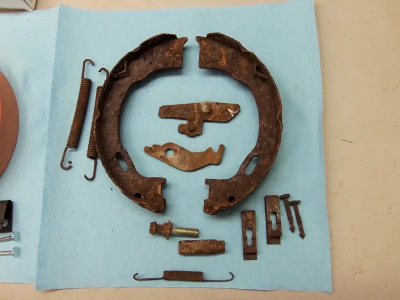

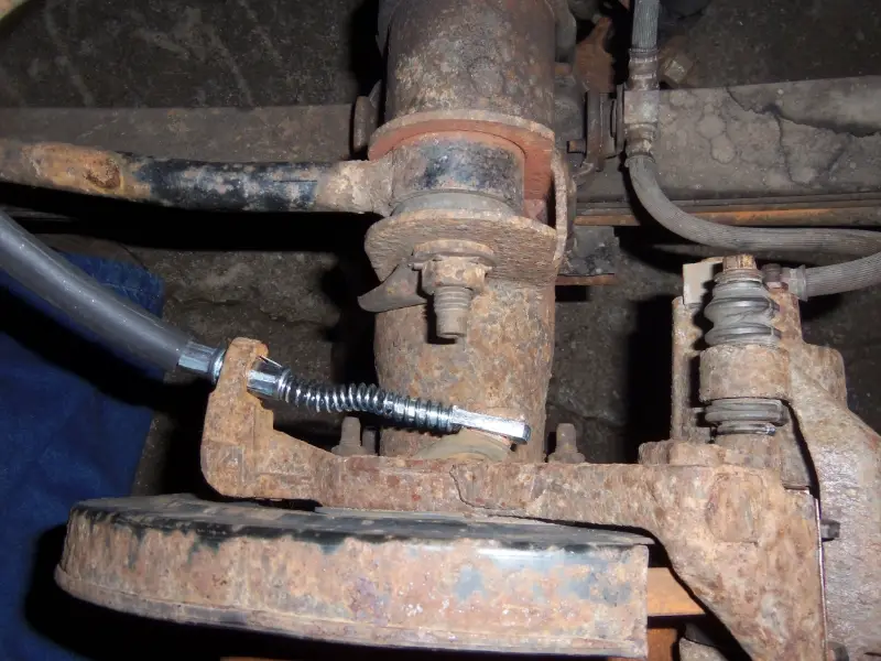

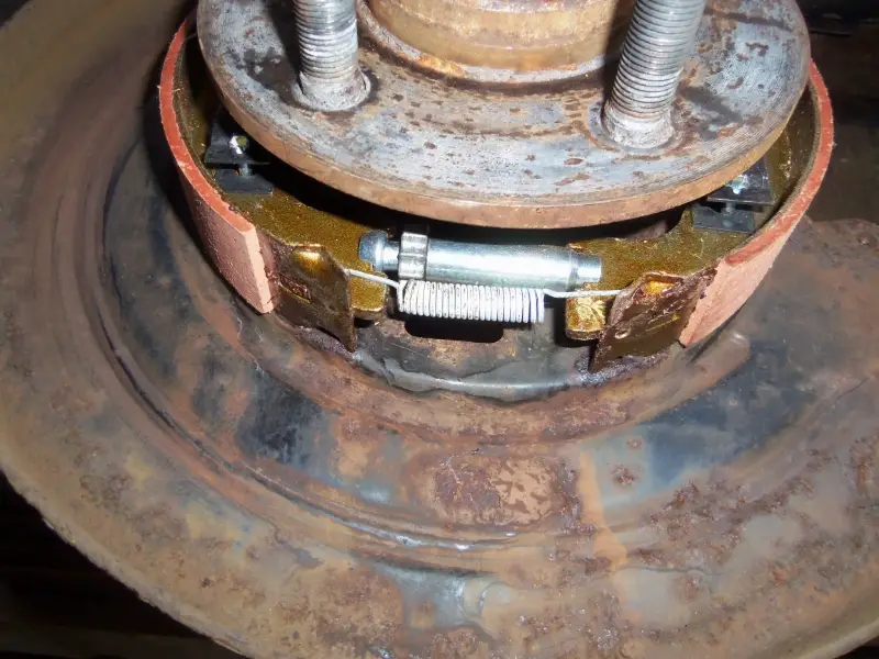

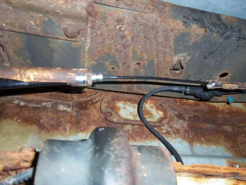

-rebuild parking brakes and replace driver's side cable
-new wheel bearings and seals, pinion seal, and change fluid in rear axle
-new U-joints in rear drive shaft
-new U-joint and CV repair kit in front drive shaft
-new CV axles and hub bearings
It doesn't need any of the above items, I just want to replace them for peace of mind.

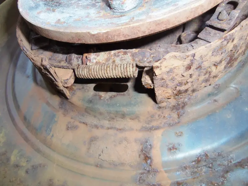

It does need calipers. The ones on it don't leak and work, but are horribly crusty. I am kicking around getting the spindles from a 2003 or so Explorer Sport to go up to 12" front brakes.

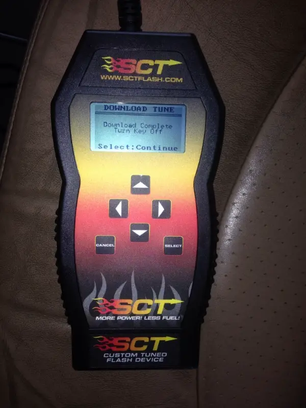

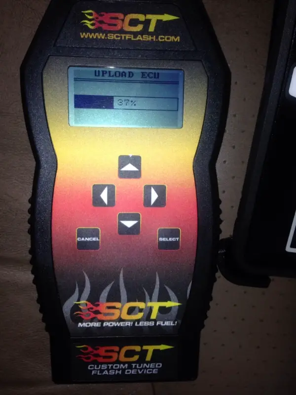

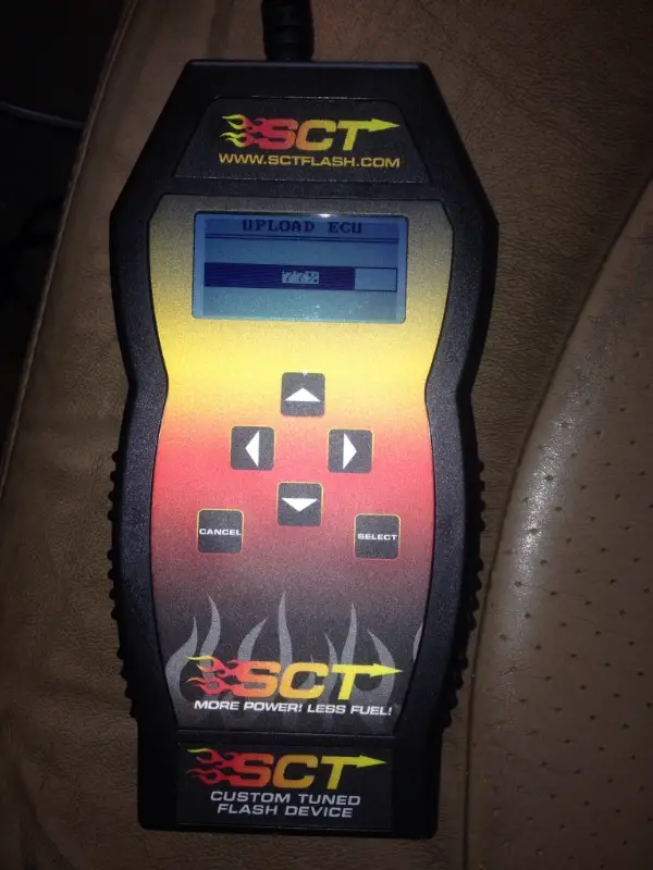

Finally got a tune!
The SCT Xcal3 I bought from qumanchew arrived last Friday. Thanks again! Saturday morning, I bought a 3 pack of tunes from James Henson, and sent him the required information in an E-mail early Monday morning. In preparation, I ran the fuel tank low then refilled it with 93 octane fuel Sunday night.
Later Monday morning, he E-mailed me 3 tunes. That man is quick!!!
I loaded the 93 Octane Street Tune into my Explorer's PCM and went for a drive. Using the tuner was quite easy and straight forward. The perfomrance of my Explorer after the tune was not a Jekyll/Hyde kind of thing. The 5.0 felt a little stronger through the whole range, and transmission shifting was firmer. I am very pleased!

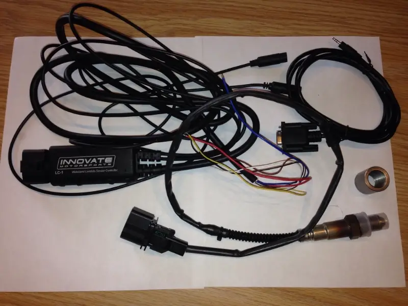

Only have one problem. At WOT, there is some detonation. I have talked to James and we are working on it.
I am now awaiting the additional O2 sensor bungs & caps, as well as the SCT 9608 analog datalogging cable to arrive. I intend to datalog AFR from my Innovate LC-1 wideband O2 sensor kit back to James with info from the PCM for better tuning.
I might have to order another LC-1 and run 3 wideband O2 sensors. On my 5.0L AWD Explorer, each exhaust head pipe has its own catalytic converter and secondary catalytic converter. The exhaust streams don't join together until they hit the main muffler by the transfer case. So, I may have to put an O2 sensor before each primary catalytic converter to get accurate AFR information from each bank.
I am waiting to see what James says about this.
More to come...

I now have parking brakes!
This may be of little importance to many, but a functioning parking brake is something I want on each of my vehicles.
Shortly after getting it home back in July, I discovered that my Explorer's parking brakes were inoperative. I took the driver's side rear caliper and rotor off to look at the parking brake assembly. I was a rusty mess. In disgust, I put it back together.
Over the past several months, as part of ordering numerous replacement parts, I ordered a driver's side actuating cable, new shoes, and a hardware kit. Yesterday, I got it all installed.
The parking brake assemblies were one big rusty, seized mess. There was no friction material anywhere. The driver's side actuating cable was seized and broken in two places.
This job was one big bitc*!!! The following points of interest caused me to invent new curse words:
-actuating cable ends stuck in connecting links
-removal of parking brake shoe OEM hold downs and nails
-installation of parking brake shoe aftermarket hold downs and nails. They were a different design than OEM
-adjusting the parking brake shoes. Not so much a bitc* as just tedious.
But, its done and my Explorer has parking brakes.
Hmmm...I wonder why it doesn't work...
On the right side, you can see the OEM shoe hold down and nail. bitc* to remove.
I'm pretty sure this cable isn't working.
New shoes, hardware, cable, and cable to frame retaining spring.
Not good.
Better.
This end of the old cable actually broke off past the sleeve that goes into the caliper bracket.
This end looked OK, it just didn't move. New cable much better.
Very tight packaging. Ideally, I wanted to do this while I was replacing the outer wheel bearings and seals. Unfortunately, it didn't work out like that.
You can see the aftermarket shoe hold downs and nails. bitc* to install.
This is one of the rear rotors that was installed new back in early July. I used a green scotchbrite pad to remove the surface rust from the parking brake drum surface.
At the left you can see the bracket that connects the passenger's side cable to the driver's side cable. At the right, you can see the cable connecting link that I cursed at.
New driver's side cable and cable to frame retaining spring. I'm not sure why the driver's side cable is that long, and why it curves up towards the frame like that. Could be clearance for the tire...
At least this cable now moves. Yes, I know, I should consider replacing the traction bars, or at least the bushings.
So far so good. The only issue now is I think the contacts in the parking brake control light switch are oxidized. I cleaned them with contact cleaner. However, it is hit or miss whether the light illuminates when I step on the parking brake pedal. Oh well, I will replace the switch if necessary.
This is one more thing to mark off the list.
