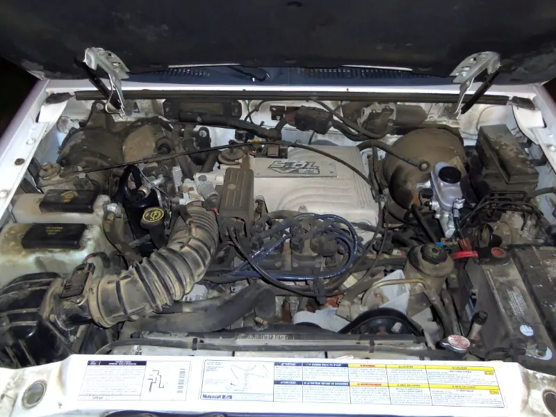

A few months ago, I decided I wanted an Explorer like Mom's. I searched all around my area. Nothing. So, why not just buy Mom's? It took me a little while to convince her, but the Explorer is now mine. :D
Here are some photos to start:

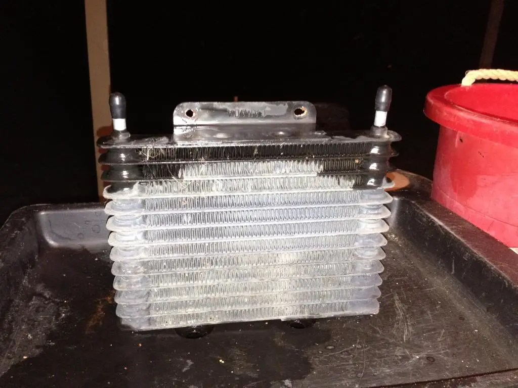

Went junkyarding this morning. Among other things, I found an external transmission cooler on a 1999 4dr 4.0 SOHC Explorer. I made sure the fluid was relatively red and chunk free before I pulled the cooler.
Here it is, filled with mineral spirits as part of the flush process. I think it might even fit in my heated ultrasonic cleaner.
My intent is to install this cooler on the driver's side of the core support, mimicking the factory trans cooler on my Explorer. I will plumb them in parallel.
Still awaiting word from the dealer on how bad it is going to hurt...

Congrats! Awesome to see the care and work you're putting into this!
I would recommend installing a transmission cooler thermostat if you're plumbing in two trans coolers. The thermostat will allow the trans to warm up to operating temp before opening up the second cooler. This helps prevent wear from cold operation for extended periods of time.
Gimme a sec and I can pull up a link to one... Here ya go.
http://www.righttoolusa.com/p/Hayde...4858655.html?gclid=CODIoIOC5bcCFZBcMgodRzQAtA
You can google and maybe find another brand or something, but that's a good start.
The only thing I'm slightly worried about would be pressure drops from both an external filter and a third trans cooler (you also have a primary one attached to the radiator). Either/or is fine, but I would try calling up a reputable transmission shop and ask their opinion on it.
Other than that, good luck on getting the Ex cleaned up, I'd love to see it fully detailed and back to factory fresh. And thanks for your service!

Hello Obie!
Thanks for replying, and thanks for the complements. I try to take pride in what I do. I don't know about factory fresh, but my Explorer will be a clean, comfortable, presentable daily driver.
I don't necessarily think its going to be a problem, but you bring up a good point. I had not thought of the effect of four items in the trans cooler line circuit: in radiator cooler, external filter, and two external coolers. To my knowledge, this is just a cooling circuit, and not part of the actual hydraulic circuit for the transmission, so I don't think the pressure drop will be a big issue. Also, to my knowledge, the 4R70W has an internal thermostat, and only ports oil to the cooling circuit after the trans warms up.
I will do more research on this. Thanks!

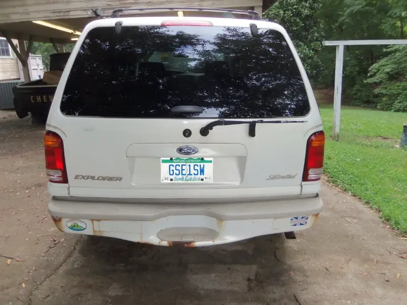

Made some progress, some good, some not so good.

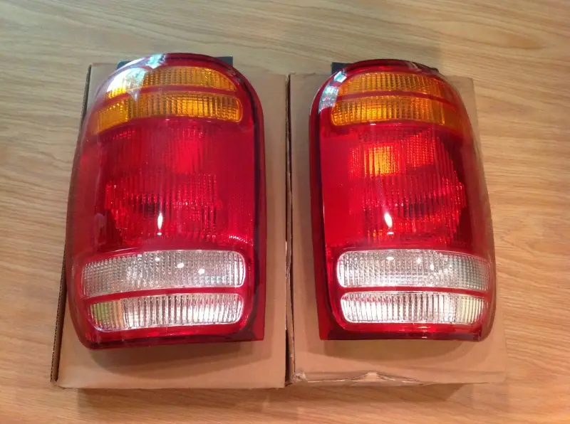

While looking at my Explorer photos again, I noticed something. The taillights don't match! The red trim around the reverse light on the driver's side assembly is gone. I bought that light for Mom a few years ago when she kissed a pole. Not sure what has happened now.
So, I bought new taillight housings. Always an excuse to buy new parts. :D
Since I now have new head/turn/parking/taillight assemblies, I went ahead and ordered a set of replacement fog lights. No photo, yet.

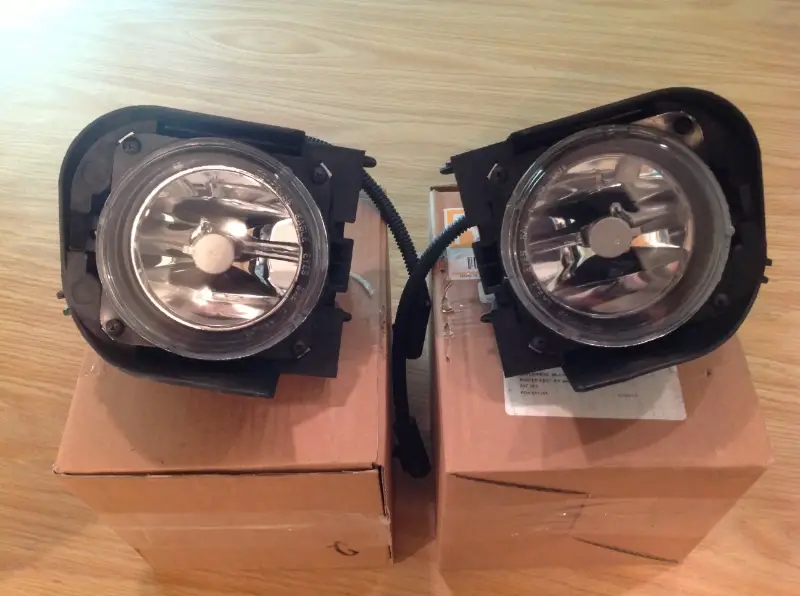

New fog lamps!
Hmmm...I now have lots of pieces and parts for my Explorer, but no Explorer.
All that will change in about 5 days...

Its mine! Picked up my Explorer from the dealership today.
Inspections, button-pushing, and getting to know my Explorer to come...
skpyle
May 5, 2013
245
7
Blacksburg, SC
1999 Limited 5.0 AWD
My Explorer at its new home...

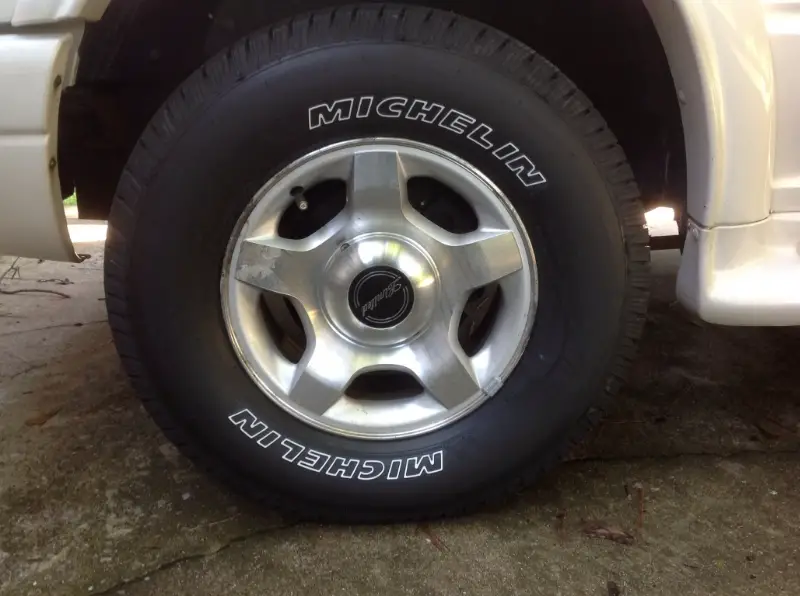

Tuesday morning, I had a new set of Michelin LTX M/S2 tires fitted to my Explorer. Much better! Vibration in the front end is gone. Cost me $800, but I am happy.

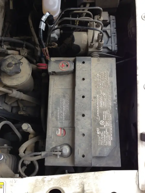

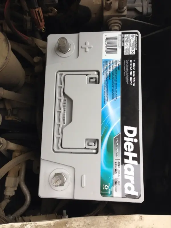

After work this morning, I am off to SEARS for a new DieHard Platinum battery. I put one in my little S-10 several months ago, and have been quite pleased.

Yeah, I know there is corrosion on the aluminum rims. I will probably start searching for a nicer set.

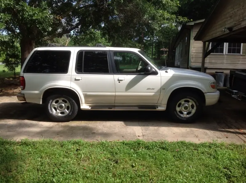

I love the moonroof, it is rarely closed.
New taillights, and they match!

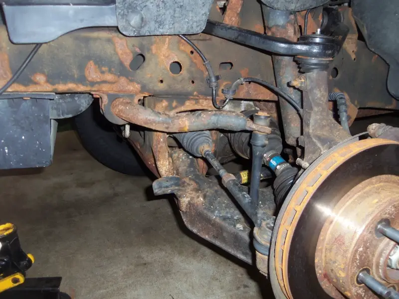

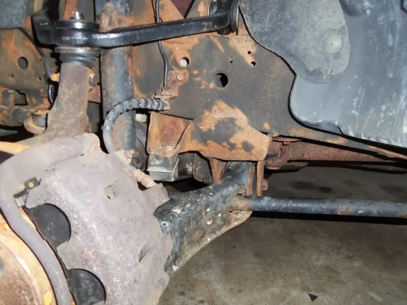

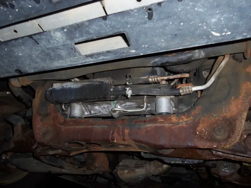

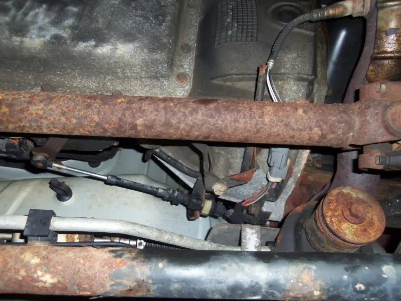

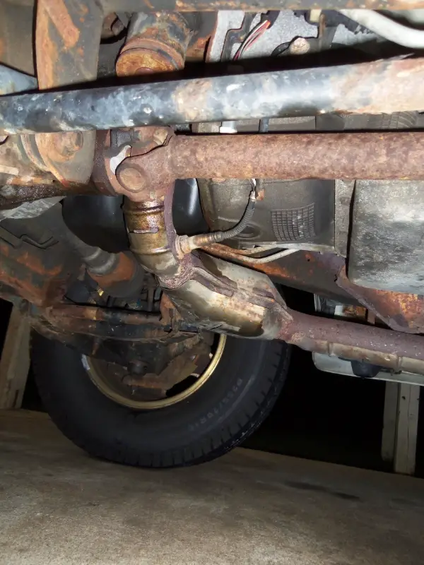

Unfortunately, my Explorer is rustier underneath than I had hoped. There are two real areas of concern for me. The rockers are rusted through in front of the rear wheels. Also, the body seams in the floors outside of the frame rails are rough. Everything else is nasty surface rust.
So be it. I will deal with it. To my knowledge, repair panels are available for the rockers.

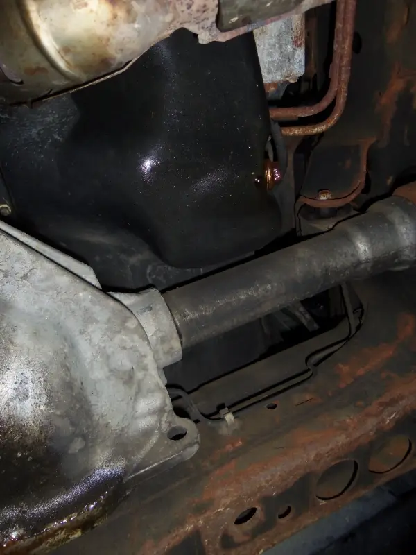

Oil on bottom of differential housing is from leaking pinion seal. I am keeping it topped off for now, until I can get the seal changed. Oil on pan is from drain plug. I have since fitted a new metal ringed rubber washer.
Oil on Y-pipe is from front pinion seal.
