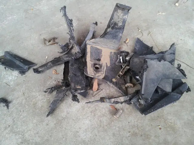

theluke19 has 33x12.5r15 Duratracs and all he's done is a 3" BL with some splash shield trimming.

I run 33 x 12.5 with no problem. TT in the front and a decent bit of trimming.
