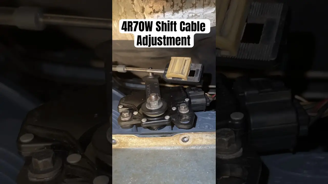

This is what the shifter cable for the exploder looks like. that white plastic clip can be adjusted to finely tune gear selection. that center clip likes to break its bushing or strip off the alignment "teeth" and likes to slide around, leading to starting issues and failure to engage park.
Yes they are all the same. They use these in the f350s e350s explorers rangers sportracs. The 2 door sport should 100% be the same
