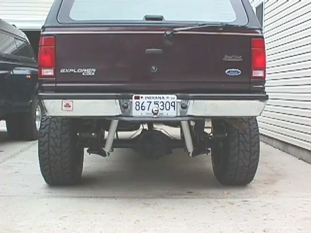

I called Skyjacker on the collapsed and extended lengths for a 6" lift on a 1st gen explorer and they gave me the measurements of
Front Ext. 22 3/4" Coll. 13 1/2"
Rear Ext. 29 3/4" Coll. 17 1/4"
Then I went on ebay and went to superlifts scratch and dent stuff and bought (2) 85280 - ext. 22.9" coll. - 13.9" and (2) 85151 ext. 30.07" coll 17.70 shocks.
Hope this helps... :)
oops....the rear may depend on where you mount them.
Mine fit like this.

Blueox, that is what I have been looking for :D I may give Bilstein a call back with thsoe numbers and see if the part #s he gave me change any. But at least now I have the numbers.
