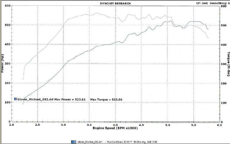

I just spoke to a man yesterday who was part of the development of the KB kits on the Fox Mustangs, when they were using 1.5/1.7 and he said a 1.8 blower. Not commonly known, but they finally hit over 500rwhp in a Fox Mustang, without an intercooler, using the GT40 intake and KB plenum. The stock block didn't survive long after the project was done, but he said the biggest problem they had was the exhaust. They ended up with 1.75" long tube headers, no cats, and 2.5" dual pipes back to the bumper. I think they were constrained by the intention of KB for much of the engine and parts. The heads were Dart, and they had to push the blower rpm to get 16psi of boost, again without an intercooler. He said forcing the air in wasn't the problem, it was the high heat from the back pressure of the exhaust, and they had to over build the fuel system and pumps to get the A/F ratio rich enough to avoid detonation.
That was a big achievement back then for sure, but there aren't examples close to that since then, as I said about 400rwhp is the typical max hp you see from a KB on a Fox Mustang. The exceptions were the custom A2A IC's that were added by welding the KB plenum to divert the airflow out the left side, and eventually back into the plenum above the GT40 lower side.
What I learned from that expert conversation was that the 2.2 blower is not likely to push 500hp at good blower rpm, and I'm not going to make it run 18,000rpm(the recommended limit). I want it down in the low teens, 12-13,000 rpm at the shift point I think would last a long time. Given what KB makes, that leaves the 2.6 size for me, so hopefully I can retire and start this Fall.
