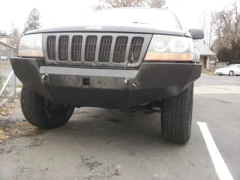

I built this for my buddies WJ:

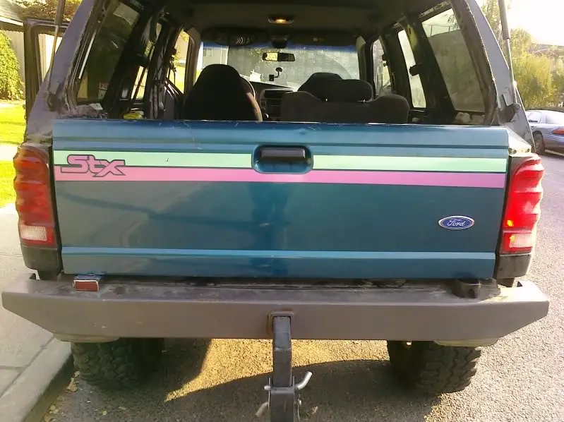

And this for the rear of my 01 Sport (nevermind the Ranger tailgate lol):
Before-
After- 3/8 steel feel bad for the ricer the rides my ass :p
Unfinished but done until I can budget some more steel plate.
I used quarter inch 2x2 square tubing to frame it and 3/16 steel to plate it. I did score a cheap grille guard from a buddy of mine that I will be cutting down the uprights to weld in this week.

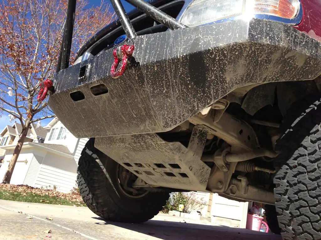

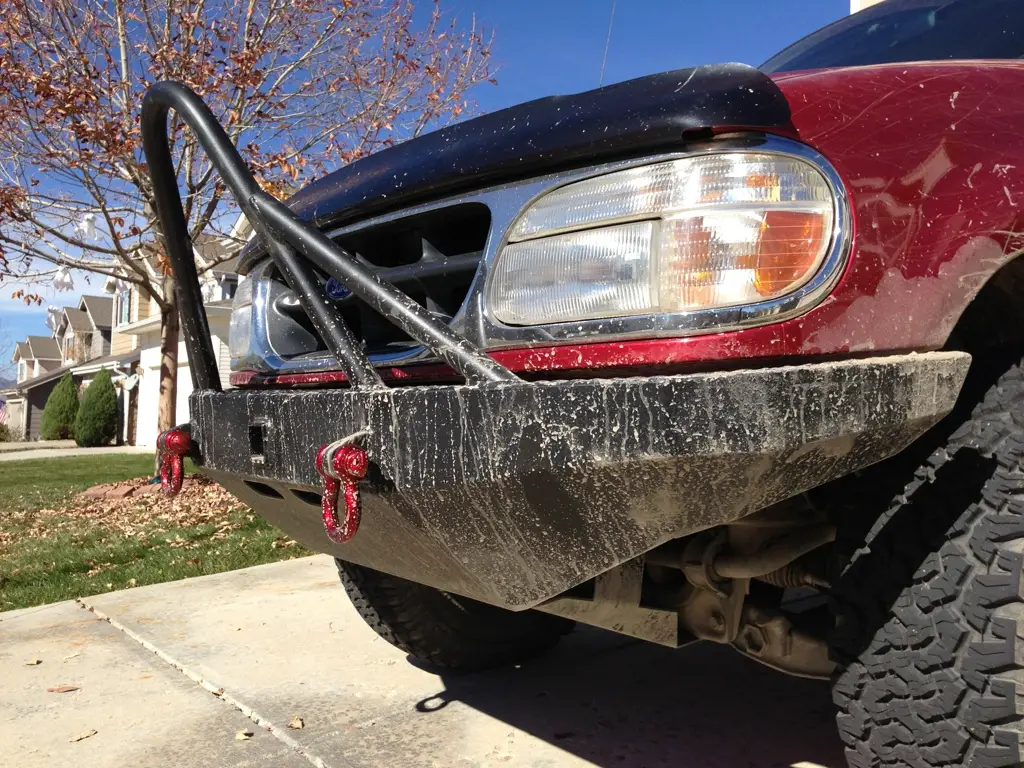

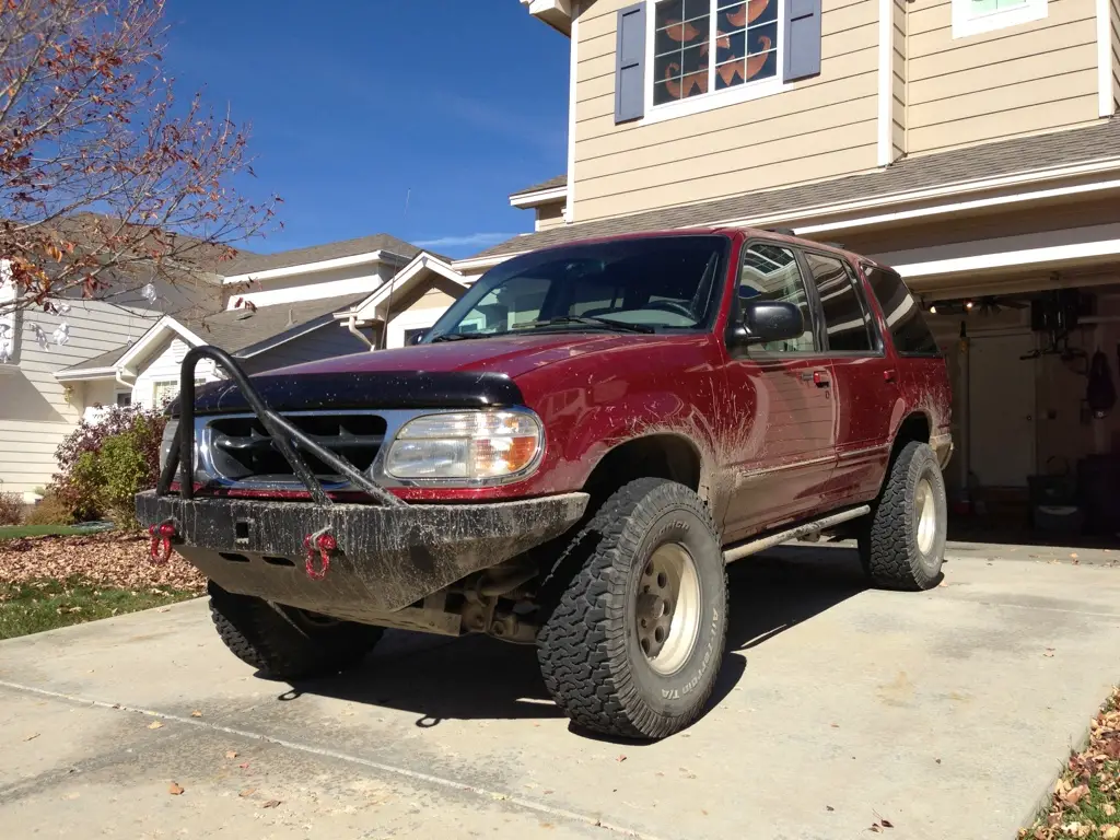

My contribution. Front is homemade, rear is a smittybilt double tube for now. Appairently I don't have a pic of the rear on the truck so I'll have to take one. The front bumper is based off of a front receiver that I turned upside down and put between the frame rails. It then has a piece of either 6 or 8 inch c channel, dont recall off the top of my head, mounted to 2 of the original bumper mount holes and a bracket welded to the hitch. The pic of the bumper has a test fit, so the bumper and the light bar are both a little crooked in the pic.

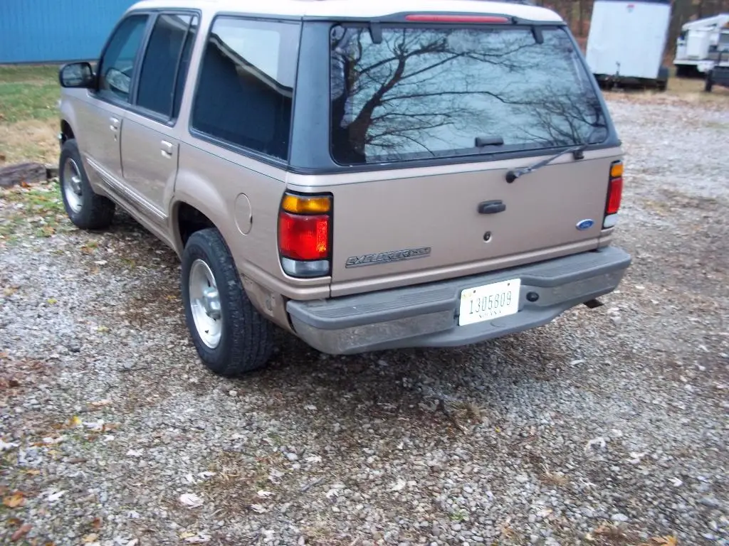

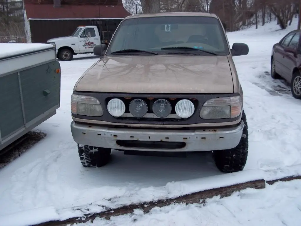

Here's what I had. I always liked the fact that it bolted to the factory location.
A member here ended up with it. I'd like to see how it worked out.

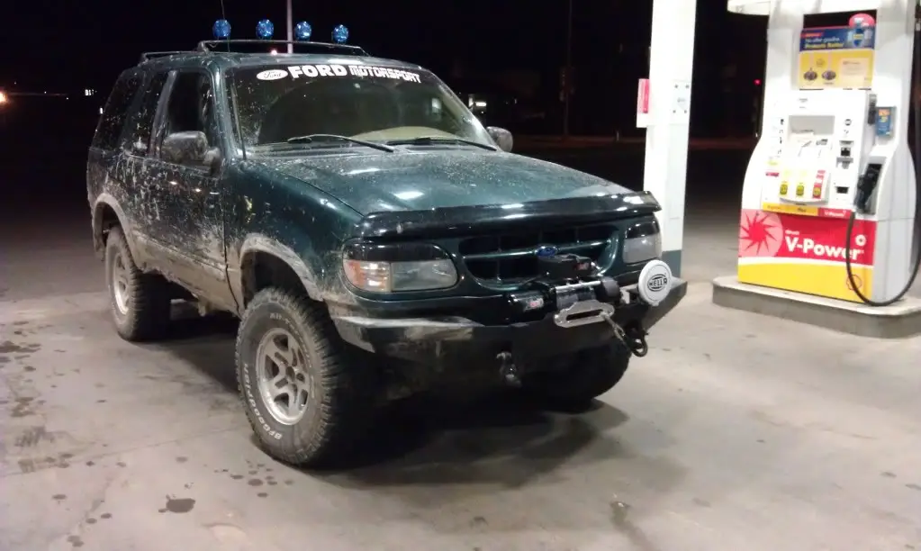

Bumper and winch done
Well, pretty much done. I have a couple lights to install yet.
beautiful fit!...wish 2nd gen bumpers fit the wheelwell opening like that!
Just following along...
Not to change the subject, but what size tires are you using and what size rim. Offset ans width. Those are what I am looking for. Love the bumper as well. Wish I had the skills to do my own.
They are 15x8 with 3.5"s of backspacing and 33x10.5s. I liked them on my ranger but found them a little skinny in mud with a heavier explorer.
