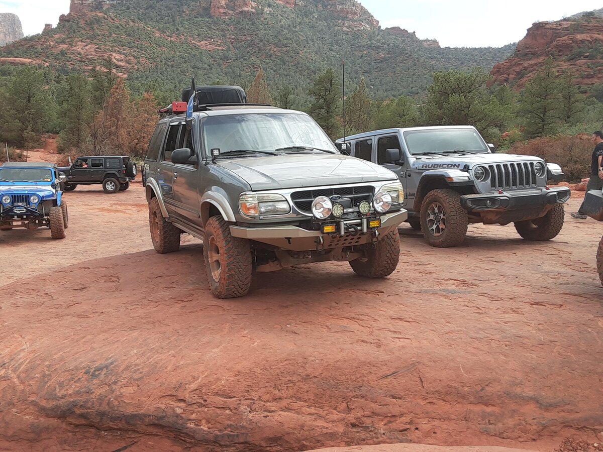

Only Downside is, with the body lift and the better clearance bumper, it sure exposes the Crossmember. I've got a skid plate on order to fix that issue however.

That reminds me of how long time member Diff Wack Daddy got his name. He was cruising along a wash near Truckhaven Hills, California, when he center punched a large rock, most of which was buried. It bent his driver side beam so bad it pulled the bolts out of the diff housing. He ran his winch line to my front bumper with a snatch block and back to the beam to pull it back sort of straight. Had to have another Explorer tie off onto my rear bumper to keep it in place. I think he went with a solid front axle shortly after.
