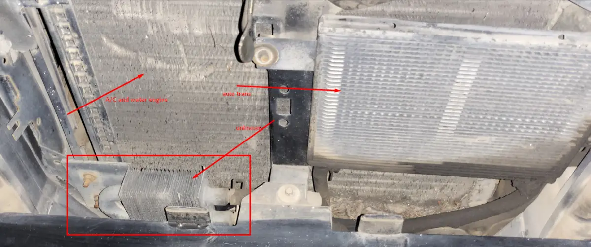

8 - I count 4 radiators in my Xplo. One is for engine, one to A/C, one to tranny (in front of all) and one tiny bitsy ipsy , near front bumper at passenger side, clote to the others. Who is this tiny one? what is cooling into?
Not sure, mine doesn't have that. Perhaps someone added an oil cooler?

8 - I´ll take a pic of that, but was night. so, shame on me, that photo isn´t good. but I´ll upload it here. .
Edit: pic uploaded

Hey people! I found what is that tiny radiator. That´s a radiator for power steering! :O
