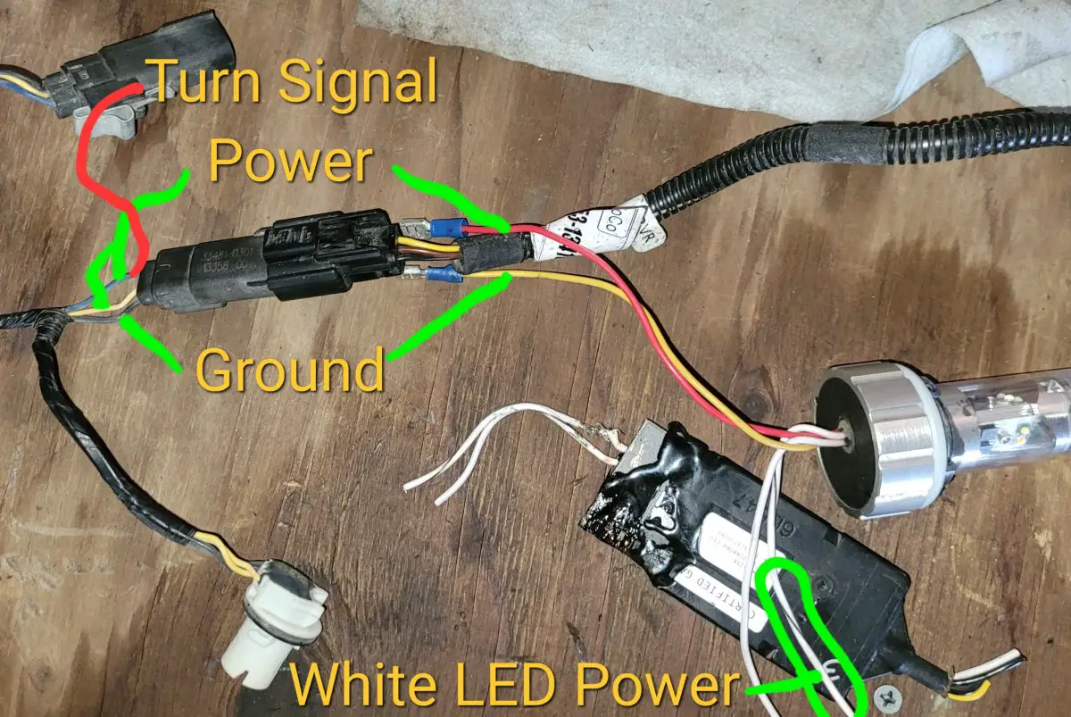

On my '15 PIU I was able to fidangle the Low Profile 3157 sockets into the housings and purchase LED 3157A (Amber) Bulbs. Now the 3157 Sockets (GM) have 3 Black wires, One wire, goes to two Pins, and the other two wires go to the other two seperate pins. I'm assuming Trader0000's colored connector is the same.
Now remember if anyone goes this route, LEDs are for Off-Road use only (disclaimer), AND they are POLARITY SENSITIVE.
I used the Two Prongs for my Ground (x2 Bigger Female Prongs on Sockets), and the smaller two seperate female prongs for Power, One prong enables a brighter LED (I used for turn signal) and the other as the Marker light LED when the FCL switch is turned on. Multimeter (Ohm & Volt meter) with be your friend here.
If you feel like you burned out the LED and the switch is on, check Fuse 30 under the Driver side Dash or turn the LED backwards, the side marker light will be off if the fuse is blown too.
Remove the 10mm on top of the Headlight Housing and hold it towards the front of the vehicle to rotate and slide the Wigwag out and finagal that Low Pro Socket into place, rotating to the sweet spot of course. Pushing it in somewhat hard as I rotated it did the trick for me as did removing the Bracket as Trader0000 did.
I rotated the LED to where the heatsink was vertical to maximize reflection and dissipate heat better as, heat rises, the "Waves/Valleys" don't stack the heat to the next "Wave/Valley". Whether that realistically makes a difference or not, my mind thinks so.

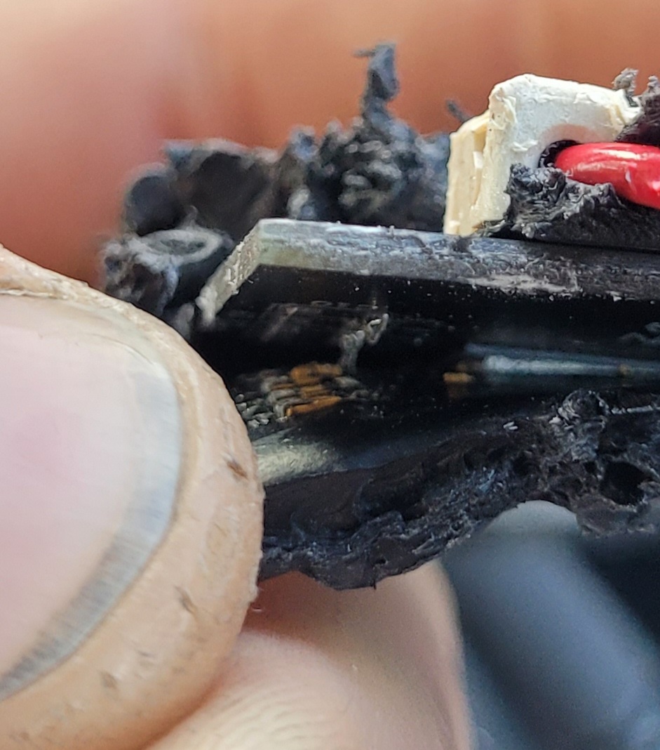

If in doubt use the OP's method, the white LEDs are pretty bright. I discovered that my Wigwags were fine however the Hard Rubber Black Module had a couple capacitors that became desoldered and applying pressure or tightly wrapping tape where they were, made the turn signals work again, til the tape loosened anyways.
Wiring the Wigwag Bulbs worked for me too, except I accidently burnt out 1 of 3 LEDs while testing it.
So to summarize my rediculous writing, Get;
3157 Sockets & Bulbs, then wire as follows;
WigWag Bulb - Yellow to Harness Black
Red to Harness Blue is the Turn Signal
Red to Harness Yellow is Marker LED.
The Harness changes Wires colors with the Wigwag pigtail, so I'm referring to the Side Marker 'Harness' Colors.
Here are some confidence photos
Heres a Photo of the Capacitor/Resistor problem if anyone cares.

I decided to Cut away at the Rubber piece by piece. As you can see part of the circuit is melted into the rubber instead of the Circuit Board.
