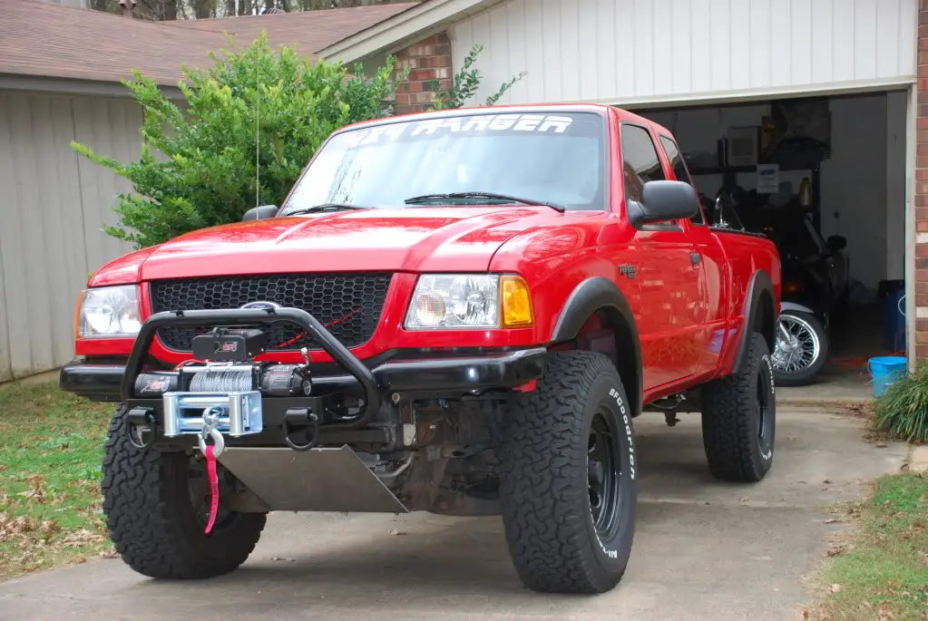

For your front skid, you are going to have to make one, or get one that comes included with a drop bracket lift kit.

You can get a front one done pretty cheap, especially if you know someone with a welding shop. A buddy of mine did mine and welded the mounting tabs for me.
