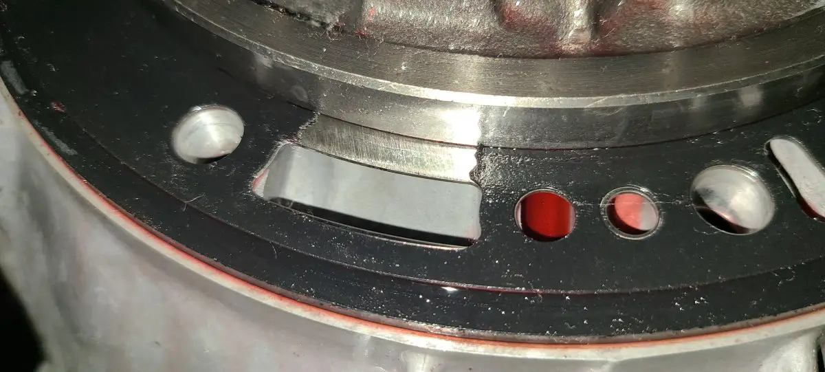

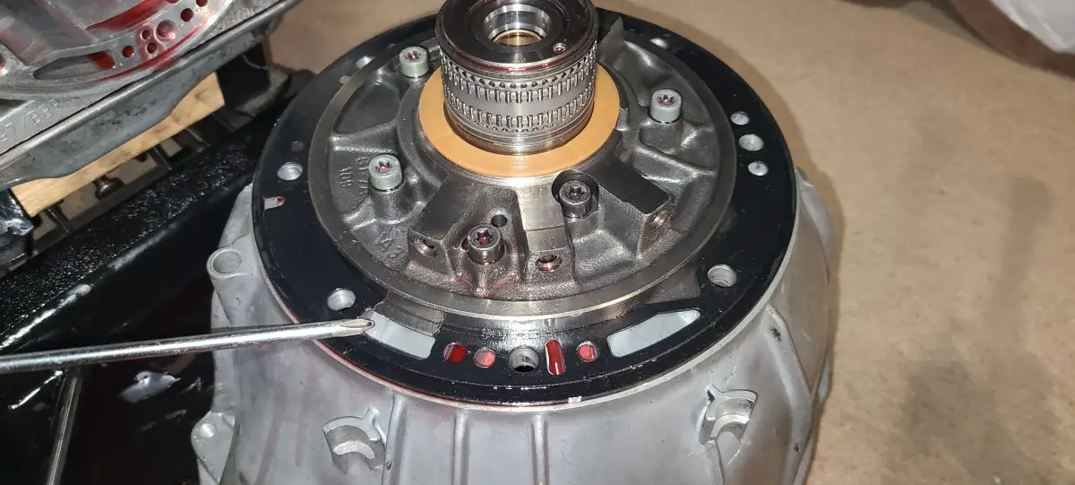

Yee-up. I reckon that would do it...
Didn't help that all 8 bell housing bolts were loose. I thought I torqued them down, but maybe not?
Yup, that was it. Pump bolts were all good, but I apparently hadn't torqued the bell housing bolts down to spec. Now it's good'n'tight, and the rig is running stong!
