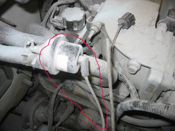

sounds like it could be steam from one of the water lines aroung the water pump or thermostat assembly :dunno: it's really hard to determine when it is third hand information, and your not sure where it is coming from.
OK-she probably kicked on the heater for the first time in awhile-hmmm
Most likely thing would be the heater bypass valve--
Dirty picture yes-but it is near the throttle body-and they do leak--

Yeah, That is what I orginally thought. It is possible that it could be a head gasket or hopefully not, a cracked head. I just can't tell based on her description. I am sending someone there later today to look at it so I know what I am up against should I go there and fix it tomorrow. THANKS for the reply.
I didn't think about the heater bypass valve. Will have them check for that also. THANKS for the information!
no gasoline smell. Thanks for the reply. Just "stinky" as an 18 y/o would describe. It is something to do with water pump, head gasket, heater bypass valve leak. something like that is my guess. I also changed out the throttle body air control valve earlier this year. I am not sure if I may have hit something and it finally broke.
