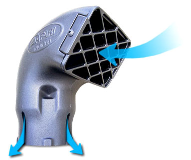

All Safari Charge Air Rams feature a highly effective water separator system built right into the air ram in order to remove rain water from the incoming air stream - thus ensuring safe engine operation through even the most torrential tropical storms.
An added benefit of the unique Safari Charge Air Ram is that it can be rotated to any position. This means great peace of mind for those who plan to travel in cold or high altitude conditions where heavy snow falls are anticipated. By rotating the air ram to face away from the prevailing wind/direction of motion, the air ram delivers additional protection from the choking effects of snow build-up inside the air intake.
