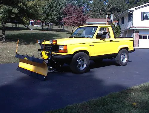

Anyone have pics of the plow mounts on a 1st gen Ex? I want to modify the mount from my '90 BII to fit a '91 Ex frame and would like to see a factory set up if possible. Thanks.
BTW, here's the plow on my BII...
And here's the '91 frame it's going on...
