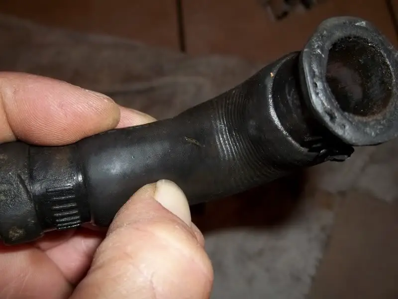

Coolant Bypass Hose. It will split on the inside like this

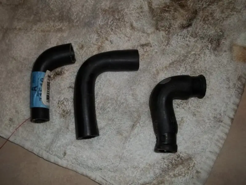

Here is a picture of original on right, Gates Replacement in center, Dayco ( autozone) on left. The dayco actually fit better. I have since replaced it with a motorcraft hose from rockauto.com
You do need the special hose, as it is formed, and, 3/4" on one end, 5/8" on the other.

Really glad somebody knew about this! So I wasn't wrong in thinking it was a bypass hose. I have a feeling that is where my coolant is going, every so aften I need to add a splash.
I will have to order one from Rockauto soon then, I am going to make a rather large order, including Rear Shocks, 5th Shock, Rear Brake flex line, and now this bypass hose. it will be like X-Mas all over again!
