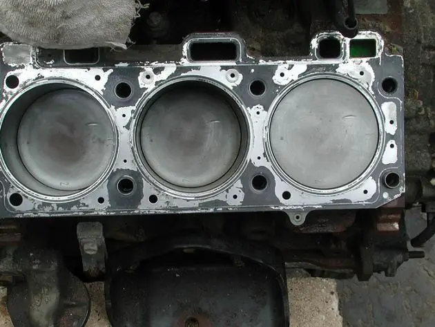

If the left (front) or right (rear) cassette guide is broken then the chain can slip enough that the pistons will strike the valves.
Some members have driven 50K miles after hearing and ignoring the warning sounds. Other members got no warning at all - chain slipped as soon as the guide broke.

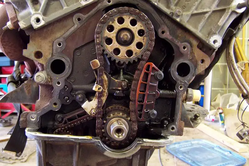

Pull the small steel oil pan off and see if you have debris down there. Very easy job
Read all of 2000StreetRod's threads on the subject. That's as close to a definitive guide as it gets.
It's interesting that you mention reading that the front components are the ones that fail more often. I have seen this mentioned before too. I don't know where this comes from (maybe wishful thinking?). In my experience, and from all the accounts I have read about, the rear chain components are the ones that are much more likely to fail, and when the rear guide fails it seems to more likely result in a skipped chain than when it happens on the front.

Replacing that tensioner actually cost me an engine. My rear guide was apparently already cracked. Removing the tensioner allowed the broken guide pieces to fall out (note the tension when putting the new tensioner back in). Upon startup those chucks got ground up somewhere and the chain jumped right away, smashing the valves.

The spring in the tensioner is supposed to supply tension for the chains until oil pressure builds up and takes over but the springs get weak and the chains thrash around until the oil pressure builds up and the wreck the chain guides.
Once the chain guides are wrecked there's no other solution but to replace them.

In this case, you might as well try the tensioners, since you have nothing to lose but the cost of the tensioners. Eventually the springs will weaken. Check the old ones when you remove them and see how they compare to the new tensioners. (Note that if the old ones are still full of oil they will feel much stiffer than just the spring. Squeeze the oil out first.) The spring only matters for a few seconds until the oil pressure pumps up the tensioner.
Keep an eye out for the tiny metal seal washer which will probably stick to the old one. They don't come with the new ones, so you will want to transfer the old one or order another.
If it's just the noise at cold start, then you have time. When the noise gets loud and stays there, you need to deal with the guides quickly.
