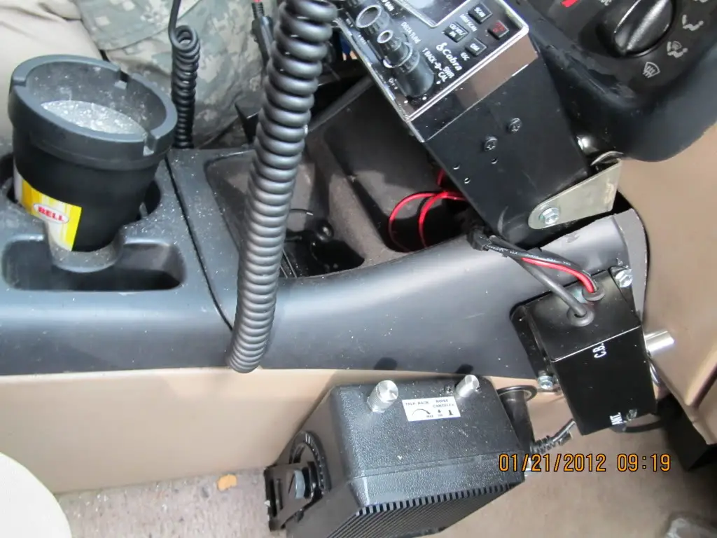

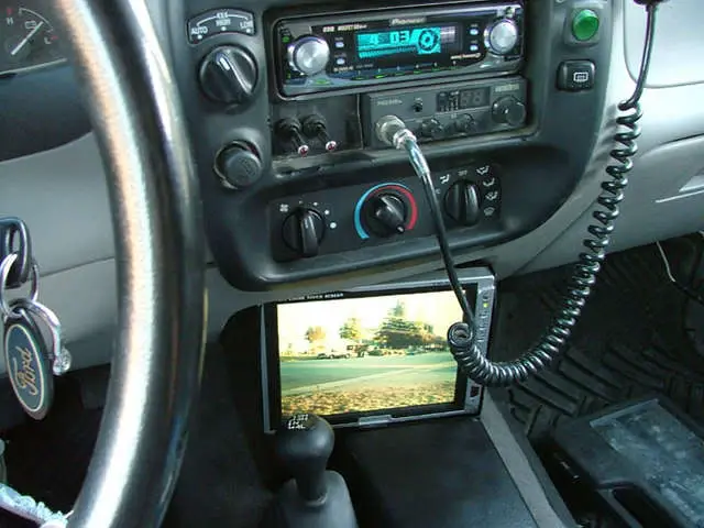

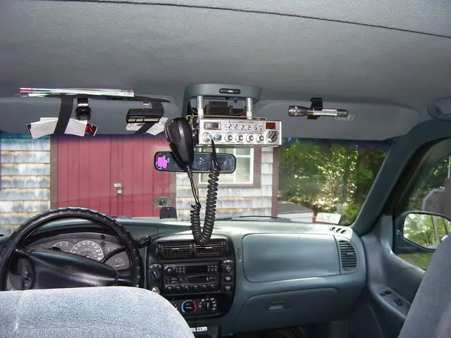

Well I finally was able to get a good price on a CB, and test fitted it with a head unit of the same size. It will FIT!!!! Yay! what I got was a FREE Midland Model 13-882B, Works, but It did not come with a mic, easy enough to get. I tested it with a mic my friends has, he is actually the one who gave it to me.
Now for the question...
1. If I where to run an inline fuse, how many AMP fuse would I run? (I downloaded the owners manual from CBTricks.com, but it says nothing about Amps, or to even use a fuse.)

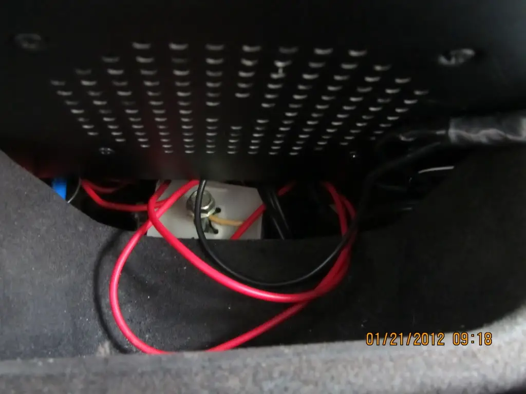

ok for the fuse a 2 amp is good ive got a 10 amp in mine i would use a 2 or 5 amp on a midland if i was you i havnt went over 5 on midlands ive all ways use a 10 on corbas and i would use the glass fuses with an in line holder now how are you hooking it up pulg in or hard wire eather way look at my post http://www.explorerforum.com/forums/showthread.php?t=344992 if you need more on how to do a switched aux. power port and your cb off the same relay let me know and ill be glad to help
Mine is 2 amp
I will use a 5 amp then. I was wondering if I should use a swtich, or find something with keyed power to hook it up to.
thing man thing is how often do you paln on using it and do you want to be drilling for a swtich mine is keyed off the same relay for the power port thats on the pass. side that is always hot but not any more lol( no more dead batterys)
OK, I was actually thinking about doing that. but as for the switched portion, I don't currently have, and really don't want to do anything with my stereo. plus I won't be using my CB all of the time, mainly for when I am bored, and want to listen to people, and when I am on roadtrips, or heading to Chicago, for traffic.
