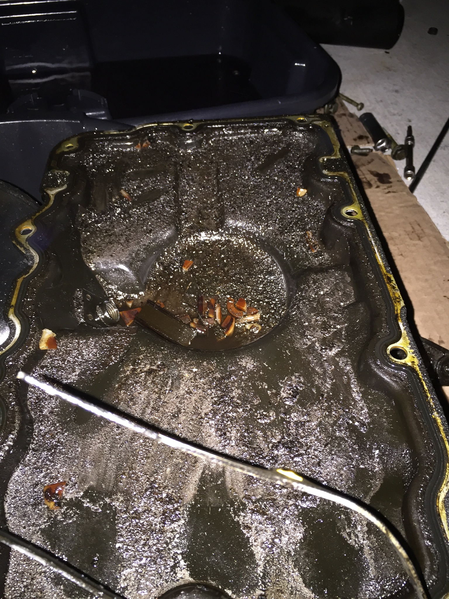

I have an issue that seems to be common to 02 Explorers (4.0 2 wheel drive, 212k) Let me say 1st, I'm like the princess and the pea, if something is wrong with my truck, I may not know exactly what it is immediately but I definitely notice instantly. I take excellent care of my vehicle, all maintenance performed on time. I even replace shocks/struts as maintanance items. Couple yrs ago, I noticed a faint knock. Brought it to the shop, found out rear timing chain guide broke off. Truck still runs very smooth. Got a couple of opinions, most said I could drive it like that for years, that it's a common issue. A few months ago, ck gauge light would come on occasionally & oil pressure gauge would drop. Take foot off brake & it came right back up & light went off. Usually happens in warm weather after driving a while. Yesterday, went to the store, knock seemed a slight bit louder when I was leaving but nothing alarming but enough to make me want to ck oil level when I got home. 1/2 mile later, ck gauge light came on, oil pressure bottomed. Shut it off, started it 5 mins later, def louder. Pulled out and into a parking lot maybe 1/8 mile from home and it sounded like I was driving a diesel!!! Limped it the very short distance home. It does still start, but i wont start it until i know it's fixed. Oil level good but smells like gas (had fuel injectors replaced Nov '17). I use Valvoline Max Life, high mileage synthetic bkend oil and have for last 9 yrs. Does this sound like the oil pump went out or the whole engine? I was going to start by pulling oil pan, replacing pump & sending unit & of course, gaskets. Would that be the best place to start or does that seem way off base? I just had it up on a lift checking it over 3 days ago. Saw valve covers leaking, already planned to replace them next week.
