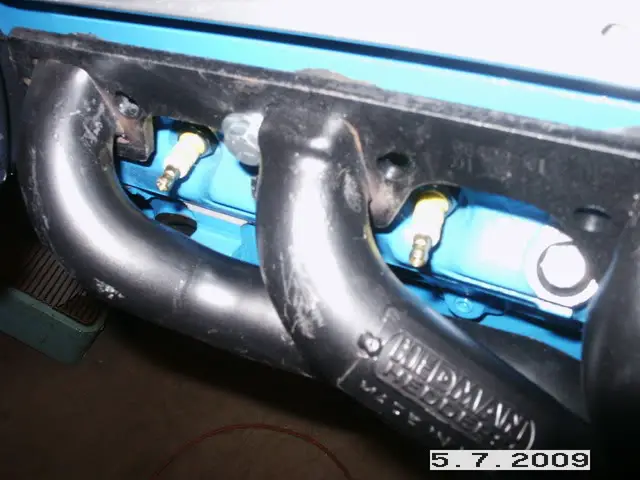

here is what the area looks like with some nuts used as spacers.
hmm...I think a 90 deg boot will still touch the tubes...

I have the SAME headers, and the SAME Heads. GT-40P heads are NOTORIOUS for this problem. They are the BEST Factory Head that Ford ever put on the 5.0L/5.8L BUT at the cost of a PITA to deal with exhaust issues.
Instead of coming out of the head at an angle that allows the exhaust tubes to angle close to the head, the P heads have the plugs coming out almost perfectly perpendicular to the crank centerline. Which has them crashing into the primaries in most applications.
Matt is attempting to shorter (1/4"?) plugs in combination with a 1/2" spacer. and another gasket.
In my trial fits, the exhaust tube LITERALLY touches the first 2 plugs on the drivers side.
I am going to re-route the tubes so they go straight down, THEN over to the collector.
